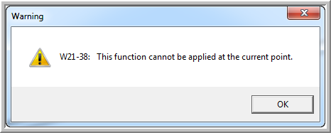

The following is displayed when using AutoPIPE
Warning
W21-38: This function cannot be applied at the current point.
OK
Why does it appear and What should i do now to avoid it?
There are some commands in AutoPIPE that can not be performed at certain locations in the mode
A. Inserting a Tee at a Bend Near / Far / Mid / TIP Point.
B. inserting a new segment at the start / end of a valve.
C. Splitting a Segment into 2 segments at a Bend Near / Far / Mid / TIP point
D. etc...
The only work around its to not perform the operation at this point. Try selecting a normal Run point.
