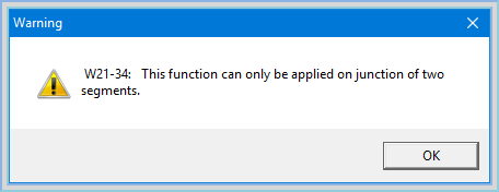

The following is displayed when using AutoPIPE
Warning
W21-34: This function can only be applied on junction of two segments.
OK
Why does it appear and What should i do now to avoid it?

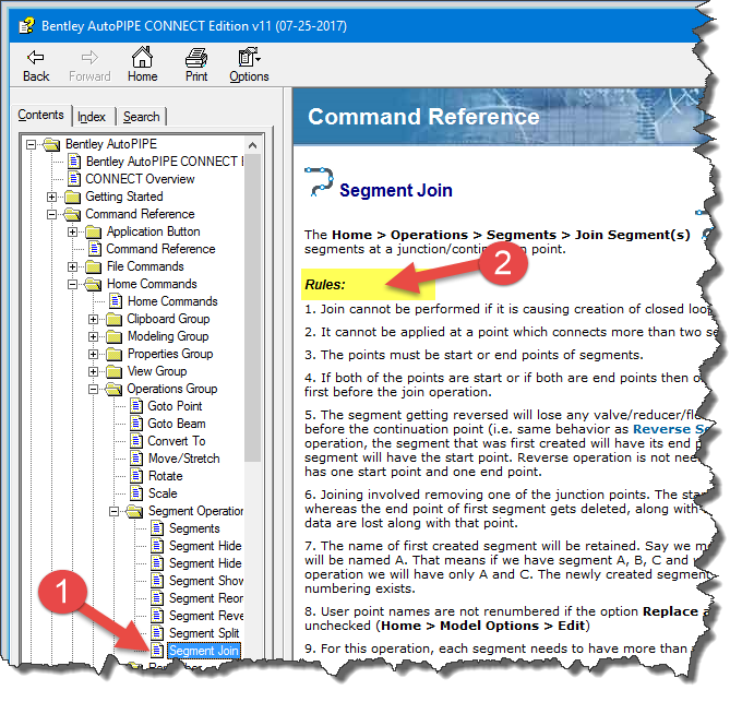

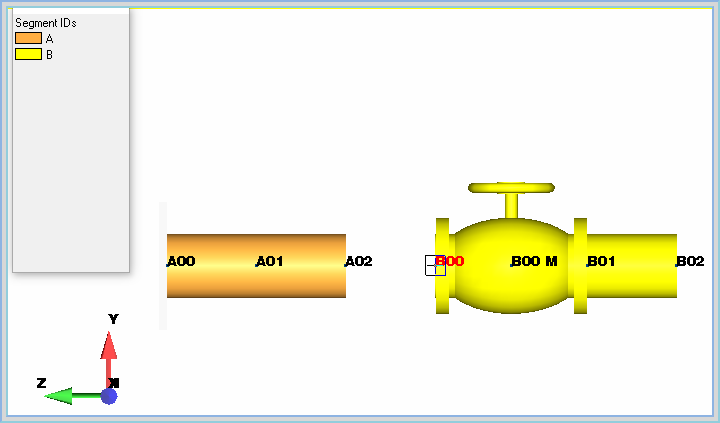

There are some commands in AutoPIPE that can not be performed at certain locations in the mode. For instance, joining 2 segments where where one segment starts with a Valve.

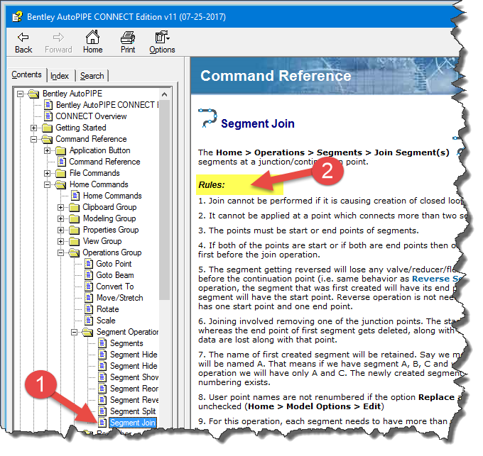

Note: there are multiple rules associated with joining segments. Please review them all in AutoPIPE help.
Avoidance:
As mentioned above this operation can only be performed between 2 run points and not at a location of a run and component (i.e. Valve face, bend, etc..).

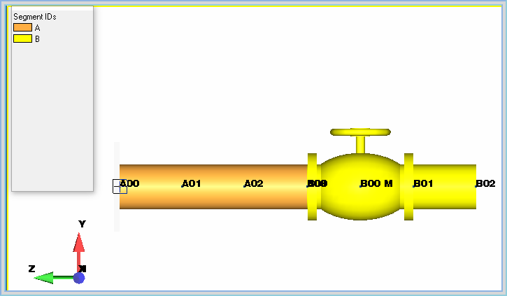

Example:
Joint segment A and B together to form a single segment..
Step #1:
If necessary, add a new temporary node point on segment A before valve, otherwise delete the last node point on Segment A.
Note, last node point on Segment A is now A02.

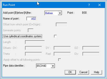

Step #2:
Select the 1st node point on Segment B, face of valve, B00

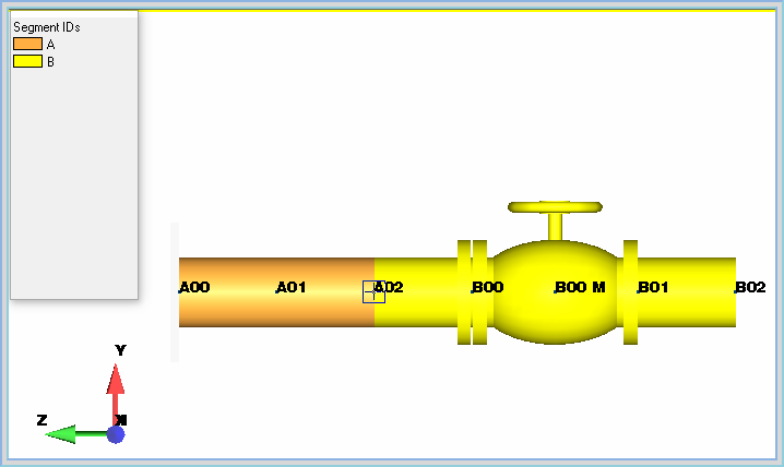

Step #3:
Insert Run from front of valve face  (B00) to last node point of previous segment, A02

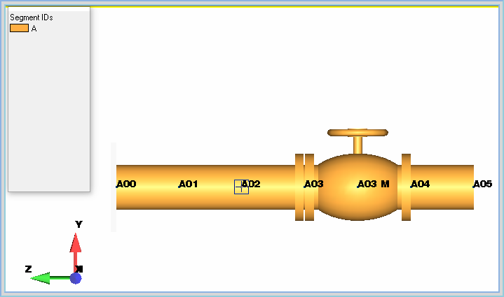

Step #4:
Use Segment Join command to join both segments.
