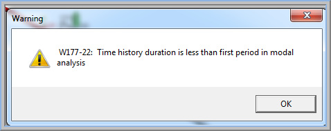

The Following warning occurred when perform an Time History analysis
Warning
W177-22: Time history duration is less than first period in modal analysis
OK
Why and how to avoid?

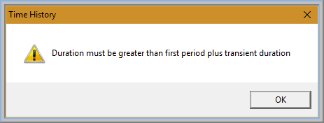

 This occurred because the user was able to enter a duration time that was less than  required by the analysis. The new version of AutoPIPE displays the  following Warning immediately when the duration time is entered on the Time History dialog, and is more descriptive of why it is being displayed:
Time History
Duration must be greater than first period plus transient duration
OK
