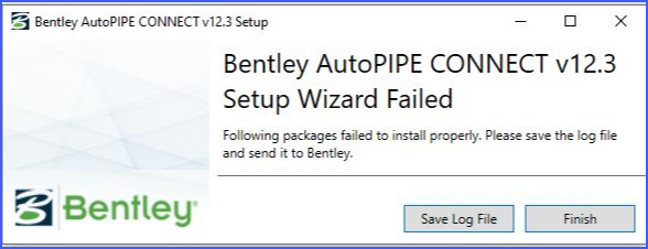

While installing the application the application displayed the following:
After the installation abort, the following was found in the error log file:
i360: Creating a system restore point.
w363: Could not create system restore point, error: 0x80070422. Continuing...
i370: Session begin, registration key: SOFTWARE\Microsoft\Windows\CurrentVersion\Uninstall\...
e000: Error 0x8007051b: Failed to secure cache path: C:\ProgramData\Package Cache\
e000: Error 0x8007051b: Failed to secure cache directory: C:\ProgramData\Package Cache\
Why is this happening and how to Avoid it?

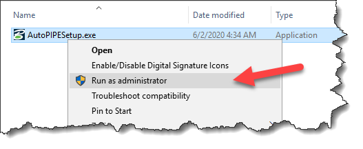

6. Only after completing step 5 above continue here, try to install the AutoPIPE by right mouse clicking on the installer file and select "Run as Administrator"
7. Use all default settings to install the application.
Does the application install correctly?
