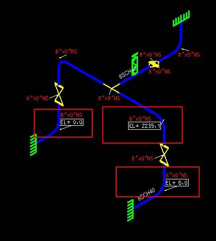

1. Elevation Labels to display where there is a change in elevation
This is the most typical use-case to only display elevation labels where required. Place following xml section in style.xml file after </StyleConverterSettings>
<Coord>
   <PlaceAtStartPoint>False</PlaceAtStartPoint>
   <PlaceAtOpenEnd>False</PlaceAtOpenEnd>
   <PlaceAtClosedEnd>False</PlaceAtClosedEnd>
   <PlaceAtEquipment>False</PlaceAtEquipment>
   <PlaceAtSheet>False</PlaceAtSheet>
   <PlaceAtExisting>False</PlaceAtExisting>
   <PlaceAtReference>False</PlaceAtReference>
   <SizeThreshold>1"</SizeThreshold>
   <ElevOnly>False</ElevOnly>
   <ElevSuppress>False</ElevSuppress>
</Coord>
This would introduce a default behavior of elevations where the elevation label would be added whenever a change in elevation property occurs..

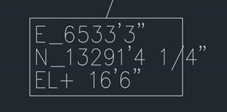

1. When exporting a Stress isometric to a DXF file, the text may overflow the bounding box and also there maybe an underscore text character used.
Use the procedure below to avoid these problems:
a. Text overlies the bounding box.
Avoidance:
Log a Bentley Service Request referencing this, ask for a patch for AutoPIPE v.11.02.00.10
or
Install AutoPIPE CONNECT v.11.03.00.xx or higher. Patch has been included into new version.
b. Eliminate the Underscore characters in elevation text:

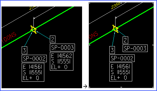

2.  The problem shows up in case of a support at the end of a pipe. A coordinate label may already be present at the pipe end
See below for before/after:
The problem also shows when multiple supports are in the same location
Please note that this only works if the user label text is exactly “$(COORD)”
