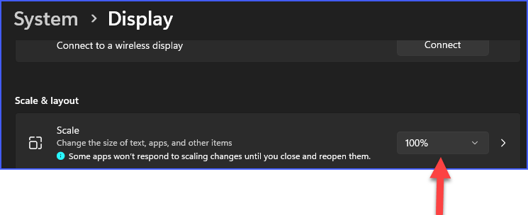

Step #1: Set Graphics resolution to 100%
Some graphic card have been known to have an issue with displaying AutoPIPE's application correctly (ex. windows, dialogs, toolbars, ribbons, etc..). One of the first steps to trouble shooting a graphics issue is to confirm your display settings scale are set to 100%. Test to see if AutoPIPE performs correctly. If yes, consider increasing the scale to your desired setting
Perform an internet search to see the steps required to changes your display scale setting.

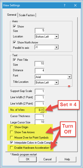

Step #3: Modify Settings in AutoPIPE
First, be sure that the model does not exceed the 10,000 node point limit. Very large models will have varying amount of lag due to their size. Recommend the following AutoPIPE settings:
Note: this can be an iterative process.
a. Switch to single line mode (View > Single Line Mode) instead of using Wire frame or Solid Model View
b. Select View> Settings> Set "No. of Wires = 4", disable the following:  Show Origin, Show Tee Arrows, Mouse Over for Point Symbbols, Hardware Acceleration
c. If the above does not help, try enabling some/all of Level of details checkboxes:
- Hide text
- Switch to line mode
- Less level of detail
View> Setup> Level of Detail>
d. Does the above steps help the application run more smoothly?

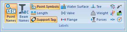

If NO, suggest to disable (i.e. Turn OFF) Point names, Support Tags, & Point Symbols by selecting icon under Show> Label>
e. Save the model to a local folder instead of the server, when completed copy file to a server location.
f. Turn off Hardware Acceleration in Windows Control Panel. Note some graphics cards may not support this feature.

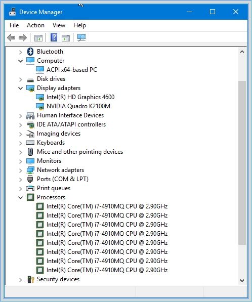

Step #4: Modify Graphic card settings
Open Windows Device manager and review "Display Adapters".
By default a computer maybe graphically processing all applications using a generic graphics processor (ex. Intel Graphics) while a much more powerful 2nd graphics card would be better suited. There are performance settings on most graphics cards to handle higher graphic laden programs like AutoPIPE, CAD systems, etc.. Making modifications to these settings will greatly increase the performance of the program.  If your computer has 2nd display adapter perform the following:

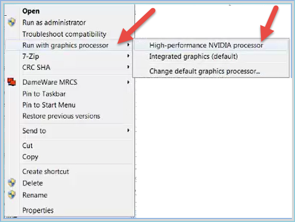

Step #1: Close all AutoPIPE programs
Step #2: Navigate to the autopipe.exe file found in the following folder:
AutoPIPE CONNECT 23 and higher:
C:\Program Files\Bentley\AutoPIPE 20xx
AutoPIPE CONNECT 10.00.00.10 and 12.08.xx.xx:
C:\Program Files (x86)\Bentley\AutoPIPE CONNECT
AutoPiPE V8i 09.06.xx - 09.01.xx.xx
C:\Bentley\AutoPIPE V8i *****

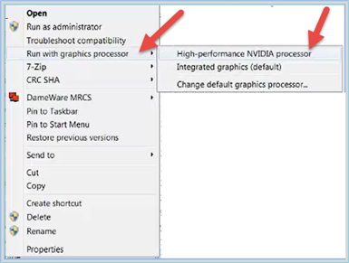

Step #3: Using the mouse, right-click on autopipe.exe
Step #4: Select Run with graphic processor, and then select High performance NVIDIA processor
Note:
1. If the computer has an NVIDIA graphics card this feature maybe turned off by default. Enable it
a. Open NVIDIA Control Panel
b. On the NVIDIA control panel, under the Desktop menu drop-down select "Add "High performance NVIDIA processor" to Context Menu".
c. Close NVIDIA control panel and try Step #3 above again.
2. The setting maybe different for your computer and graphics card settings. Research and find what setting needs to be modified on your system (Enabling Applications to run with the NVIDIA Graphics Processor)

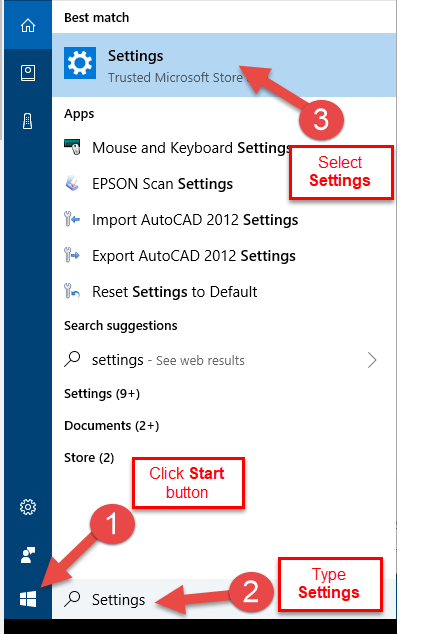

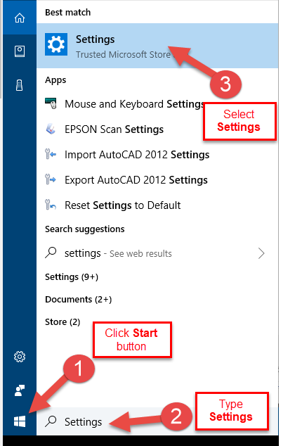

Steps to change Theme:
Step 1: Click on Start button
Step 2: Type Settings.
Step 3: Select Settings App from listing above

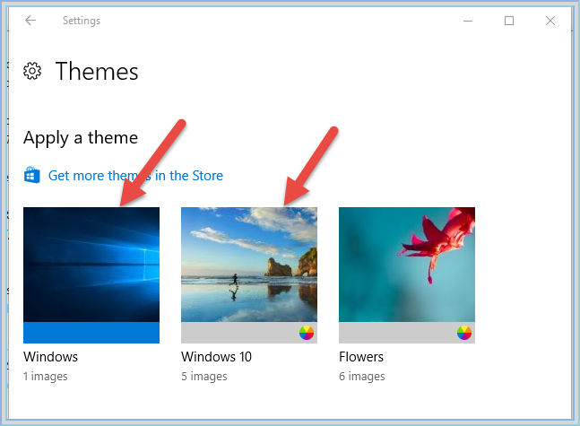

Step 4: On the left-side of the Settings app, click Personalization.
Step 5: On the left-side, click Themes.
Step 6: Click on default theme: Windows or Windows 10 image.
Step 6: Done !!!, close application.

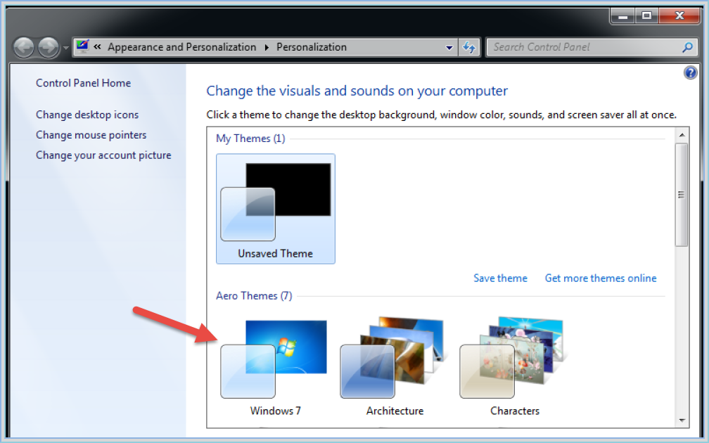

Win 7: Default theme = Aero
Step 1: Right click anywhere on the desktop.
Step 2: Select Personalization, located at the bottom of the listing.
Step 3: Select Windows 7 from the Aero Themes group listing.
Step 4: Done !!!, close application.

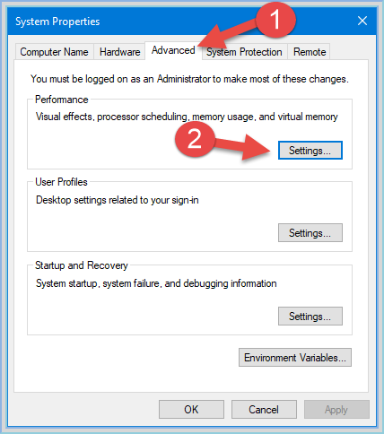

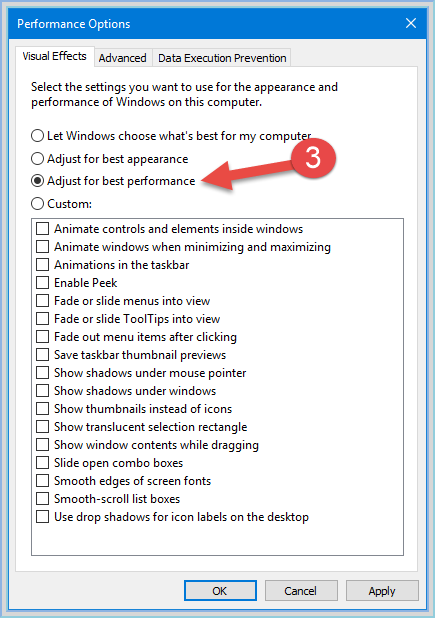

Step #8: Change Windows Performance:
1. Open the Start menu
2. type sysdm.cpl press return
3. Select Advance tab and press Settings button
4. Select radio button in front of "Adjust for best performance", and confirm most, if not all of the options below were unchecked.
Note:
Here are some possible effects to disable for better performance:
Animate windows when minimizing and maximizing
Animations in the taskbar and Start Menu
Enable transparent glass
Fade or slide menus into view
Fade or slide ToolTips into view
Fade out menu items after clicking
Show shadows under windows
Slide open combo boxes
Naturally, this and all the other possible settings are a matter of personal choice. Also, how performance is affected depends on the nature of your particular system.
