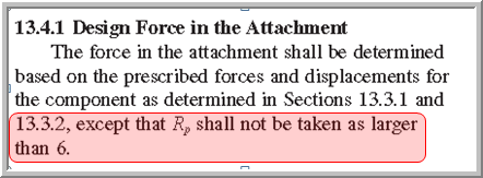

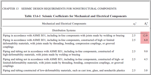

When using "ASCE 2010" Seismic Static Load Generator,
The component response factor Rp is an important factor for calculating the seismic ground acceleration.
Rp = 12 is common for stress, but ASCE-2010 paragraph 13.4.1. states that for supports/structure reactions to use a value NOT higher than 6:
One Recommendation is to run 2 sets of seismic cases
Rp = 6.0 (Support & Anchor Reactions)
Rp = 12.0 (Pipe stresses)

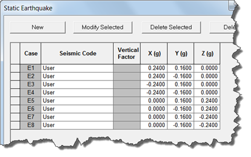

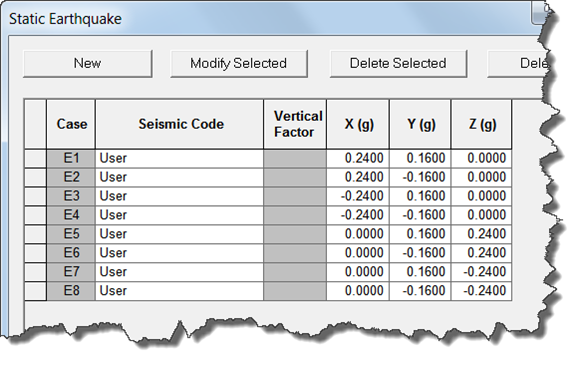

Non-Linear analysis
For static seismic cases we recommend a minimum of 8 cases as shown here which will provide the accurate non-linear support load combinations and occasional code stresses.
Define minimum of 8 static seismic cases:
+/- X +/- Y (4) and +/- Z +/- Y (4) where Y = Vertical
Note: You would typically use OP1 as the initial state.  Seismic loads at the load case level e.g. E1, E2 etc are combined as load vectors algebraically to get a resultant loading.
Horizontal X and Z seismic loads are typically not combined in the same load case.  Seismic guidelines recommend analyzing two non-concurrent horizontal seismic loadings. It is common to consider separate loadings for X and Z directions in different load cases E1 and E2 both with vertical Y component.
So only cases SUS +E1 to SUS +E8 need to be considered for occasional stress compliance.

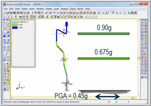

Comment #4:
For most tall structures, the greater seismic accelerations occur at the top of the structure / building.
We can use the AutoPIPE's Insert> Xtra Data>  "Member Static Earthquake factors" or "Point Static Earthquake factors" commands to model the increased seismic accelerations upward through the building / supporting steel structure.
Note:
The Static G load can be varied at different locations by factoring.  To factor all the weight you must use both the member and the point Earthquake factors.
   - Member Earthquake Factor (Insert > Xtra Data > Member Earthquake Factor) are applied to weights of pipe, pipe contents, pipe insulation etc...
   - Point Earthquake Factor (Insert > Xtra Data > Point Earthquake Factor) are applied to point loads: valve, flange, and added weight.
Typically component amplification between 1 and 2.5
