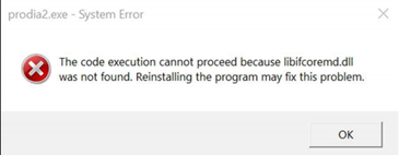

Prodia2.exe - System Error
The Fortran library is not accessible, an error message dialog (System Error) indicates that the program has not found the DLL (e.g.: libifcoremd .dll).

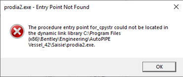

Prodia2.exe - Entry point not found
There is conflict with other versions of Fortran libraries. The program found a DLL with the same name, but it is not the correct one! In this case the error message is different (Entry Point Not Found) and it gives the name of the function it cannot find (e.g.: for__rtc_uninit_use_src).

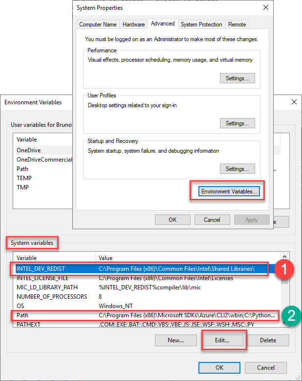

2. Checking the installation:
The installation creates a new environment variable "INTEL_DEV_REDIST" with the value of the above installation directory, and the PATH env-var is updated with [INTEL_DEV_REDIST]\redist\[ia32|intel64]\compiler and [INTEL_DEV_REDIST]\redist\[ia32|intel64]\mpirt.
The installation also adds folders containing the installed DLLs to the system PATH environment variable.
Use the “Environment Variables” Dialog for checking these variables:
Control Panel > System Properties > Environment Variables > System variables (see screenshots below)
“INTEL_DEV_REDIST” : check that the path indicated in the value correctly directs to Intel Shared Libraries.
“Path” : check that INTEL_DEV_REDIST is mentioned inside.
Check that the values circled in the precedent image directs you correctly to the Intel Libraries as shown in the image.

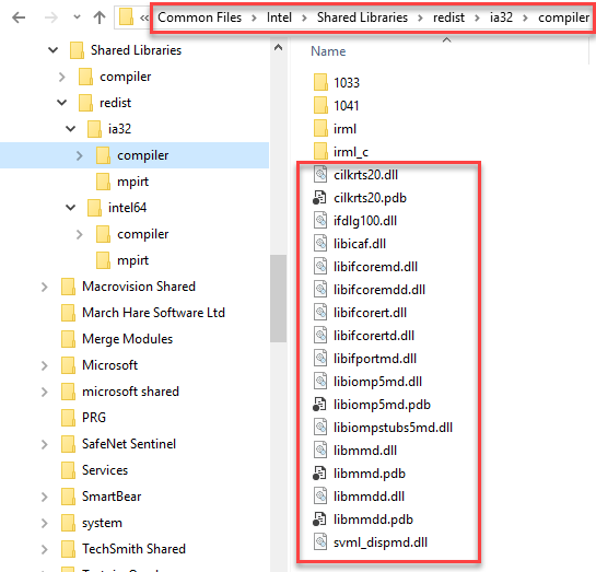

4. Workaround:
There is an ultimate workaround which consists of copying 3 files alongside the programs that need them.
Copy these 3 DLL files
a.  [INTEL_DEV_REDIST]\redist\ia32\compiler\libifcoremd.dll
b.  [INTEL_DEV_REDIST]\redist\ia32\compiler\libifportmd.dll
c.  [INTEL_DEV_REDIST]\redist\ia32\compiler\libmmd.dll
Into these 2 folders:
a.  C:\Program Files (x86)\Bentley\Engineering\AutoPIPE Vessel_42\Saisie
b.  C:\Program Files (x86)\Bentley\Engineering\AutoPIPE Vessel_42\Dessin
