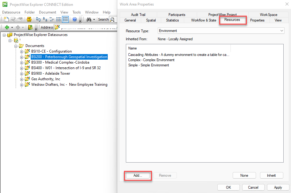

ProjectWise Administrator has created multiple Environments in a Datasource, however in ProjectWise Explorer when creating or modifying Folder Properties, not all the Environments are available.
 The Folder Properties are inherited from the above Project / Work Area which defines the Resources available to the Folders below, to resolve
  1. In ProjectWise Explorer select the Project / Work Area
  2. Right Mouse click and select ‘Properties’ from popup menu
  3. On the Project / Work Area Properties dialog select the ‘Resources’ tab
  4. Select the Resources Type: Environment to expose the list of available Datasource Environments
  5. Select ‘Add’
  6. Select the Environment to add followed by OK
  7. On the Project / Work Area Properties dialog select ‘Apply’
