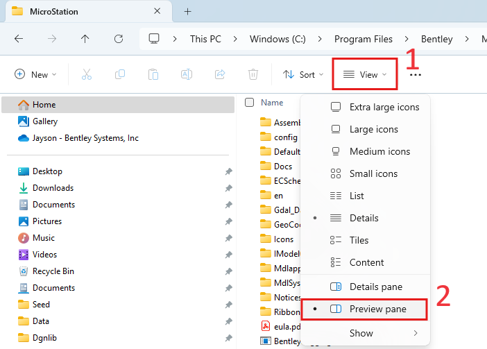

How can the Bentley DGN Preview Handler be accessed?

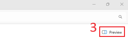

In current versions of Windows OS, the Bentley DGN Preview Handler supports a preview pane that is accessible from a drop-down menu in Windows File Explorer.

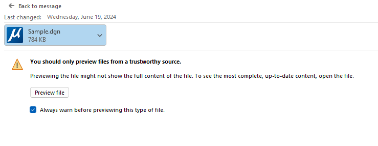

This feature is also available within Microsoft Outlook. If a .dgn file is attached to an email, then click on the attachment within Microsoft Outlook. You may be prompted with a warning message to only preview files from a trustworthy source. Click on "Preview File" to view the preview. These warning messages can be disabled by toggling off the setting "Always warn before previewing this type of file"

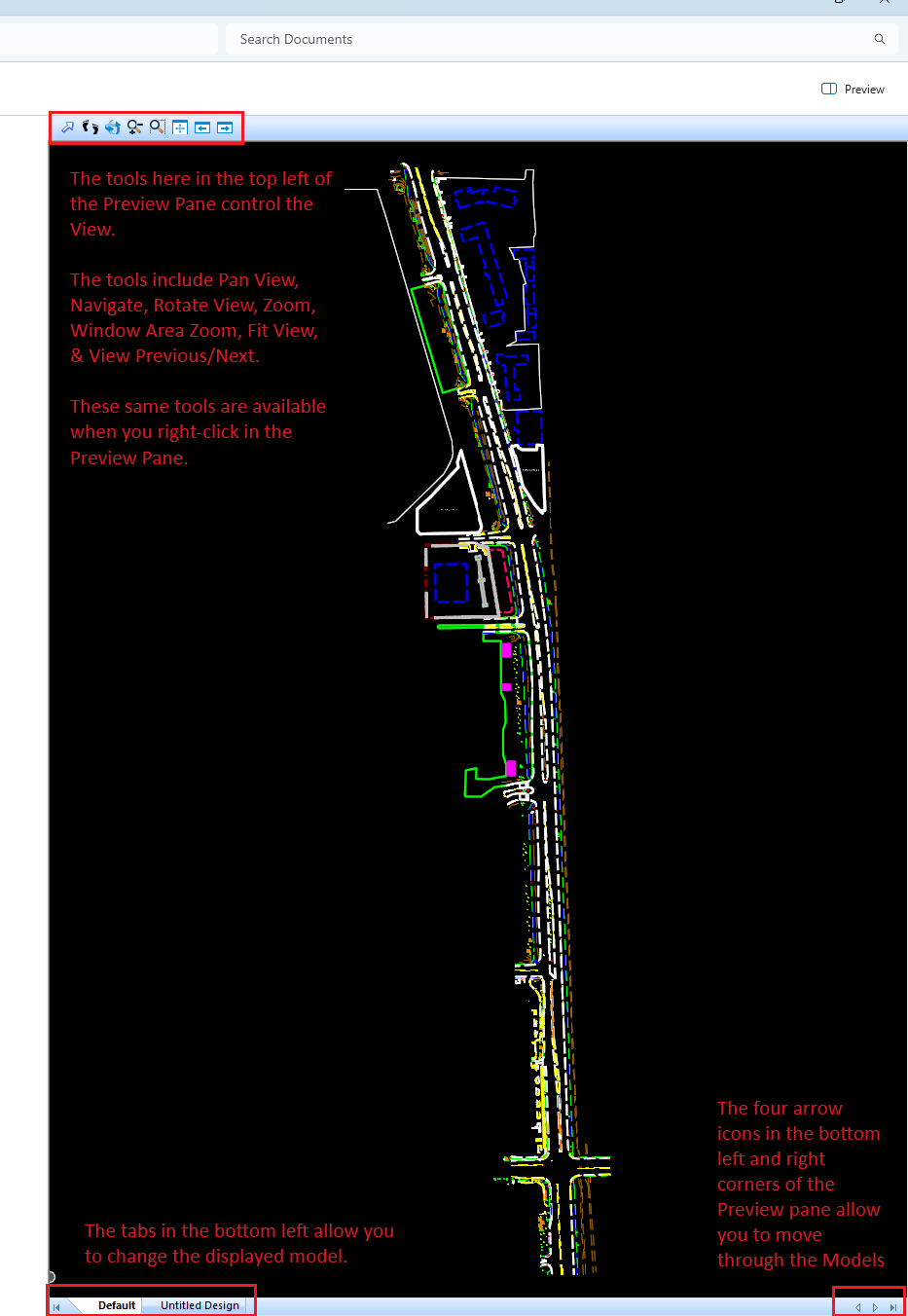

What tools are available in the Bentley DGN Preview Handler?
Here is a brief overview of the DGN Preview Handler and the contained tools.
