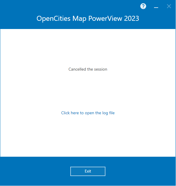

When an OpenCities Map installation is cancelled or fails, a log file of the session is created.
Before exiting the installer, the user is offered the opportunity to open this file via the prompt 'Click here to open the log file'.
The target path and file naming convention of the log file will be similar to that which follows:
C:\Users\%username%\AppData\Local\Temp\OpenCities_Map_PowerView_2023_20240617121815.log
Note the %username% operating system environment variable substitution, and that the log file name contains the full product name and timestamp of the session.
