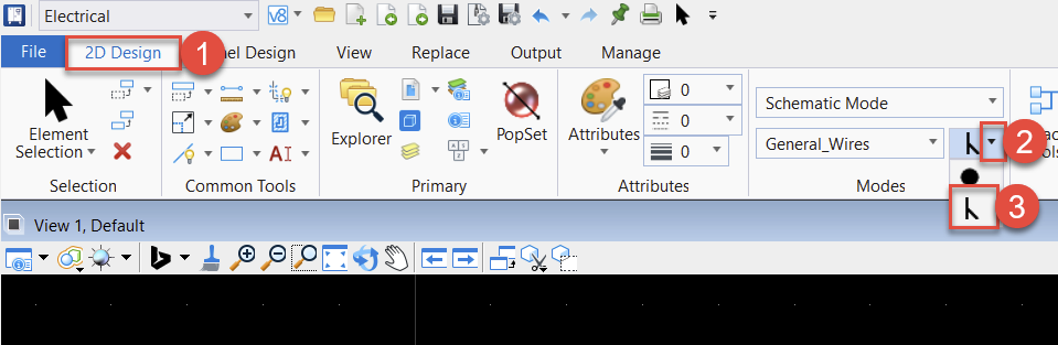

1. Open the project page where you need to connect a wire to connection point that already has a wire connection connected.
2. Change the Wire Connection Type to "Diagonal" from 2D Design >> Modes >> Wire Connection Types.

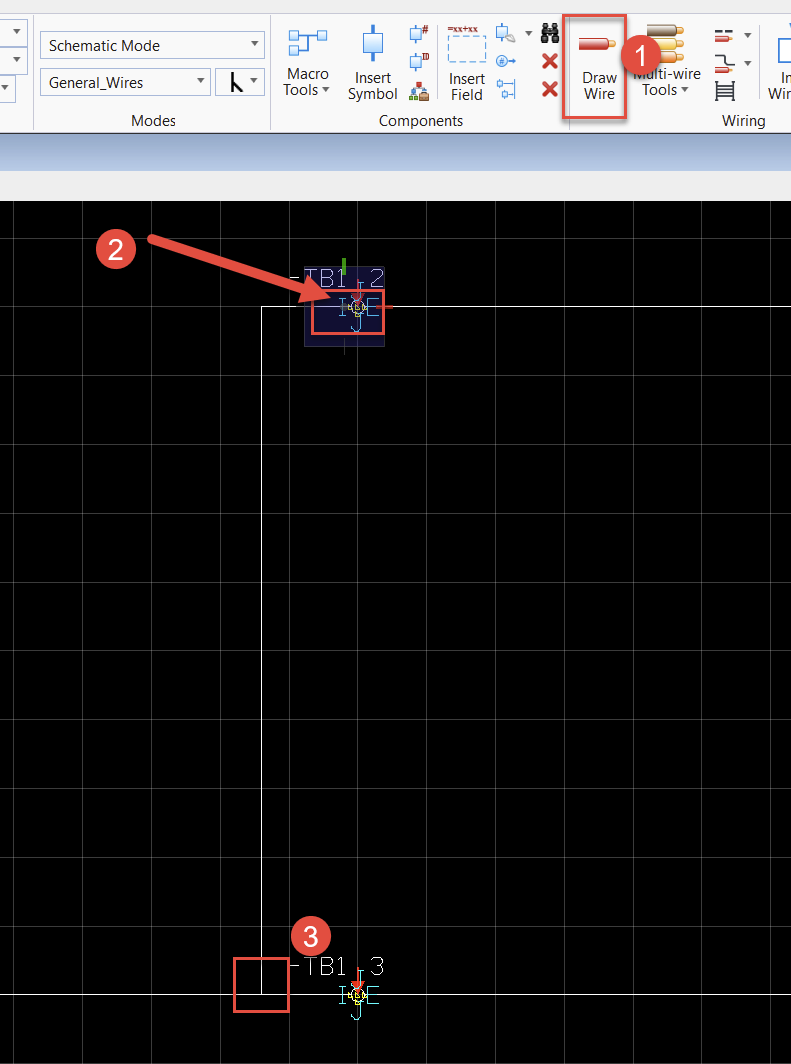

3. Next Start drawing the wire from the source connection point to the connection point that already has a wire connected. Then connect the wire to that already has connection.

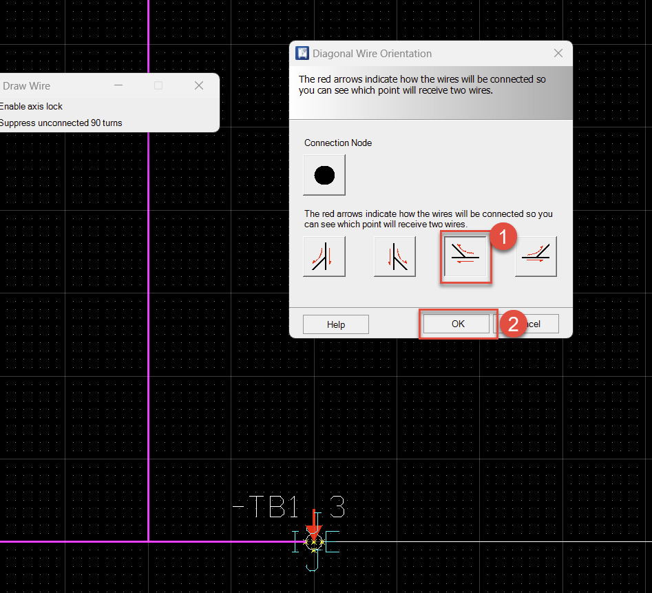

4. Now select the correct diagonal connection type and then click OK. Always select the Diagonal Connection type based on your circuit connection and wire been drawn.
