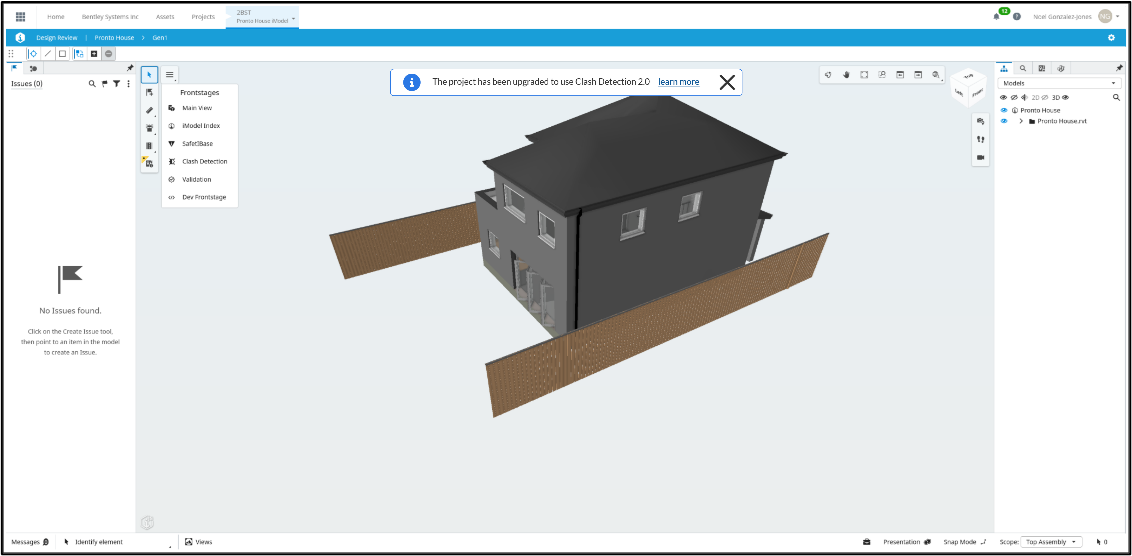

The opt-in upgrade is available only in the iModel Viewer Toolbar for enterprise project administrator roles. For standard users, a learn more option is available. A dialogue message clearly explains the upgrade process.
Additionally, a dismissible pop-up notification will notify all project users when the iModel Viewer is loaded that the project has been switched to the new version of Clash Detection.

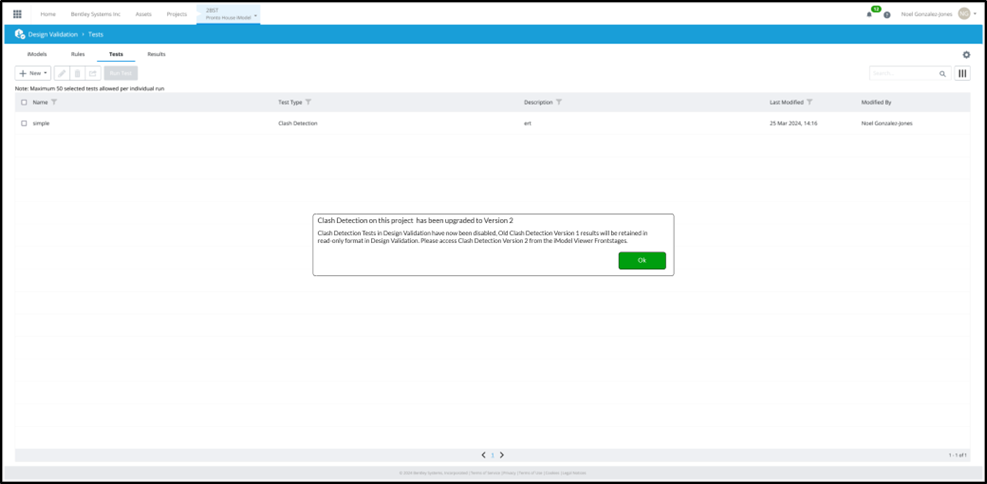

 Please note that certain features in Design Validation will be disabled. (e.g., Create Clash Detection, Edit Clash Detection) and the Design Validation Frontend will display an upgrade message.
The results from Clash V1.0 remain accessible in Design Validation.
