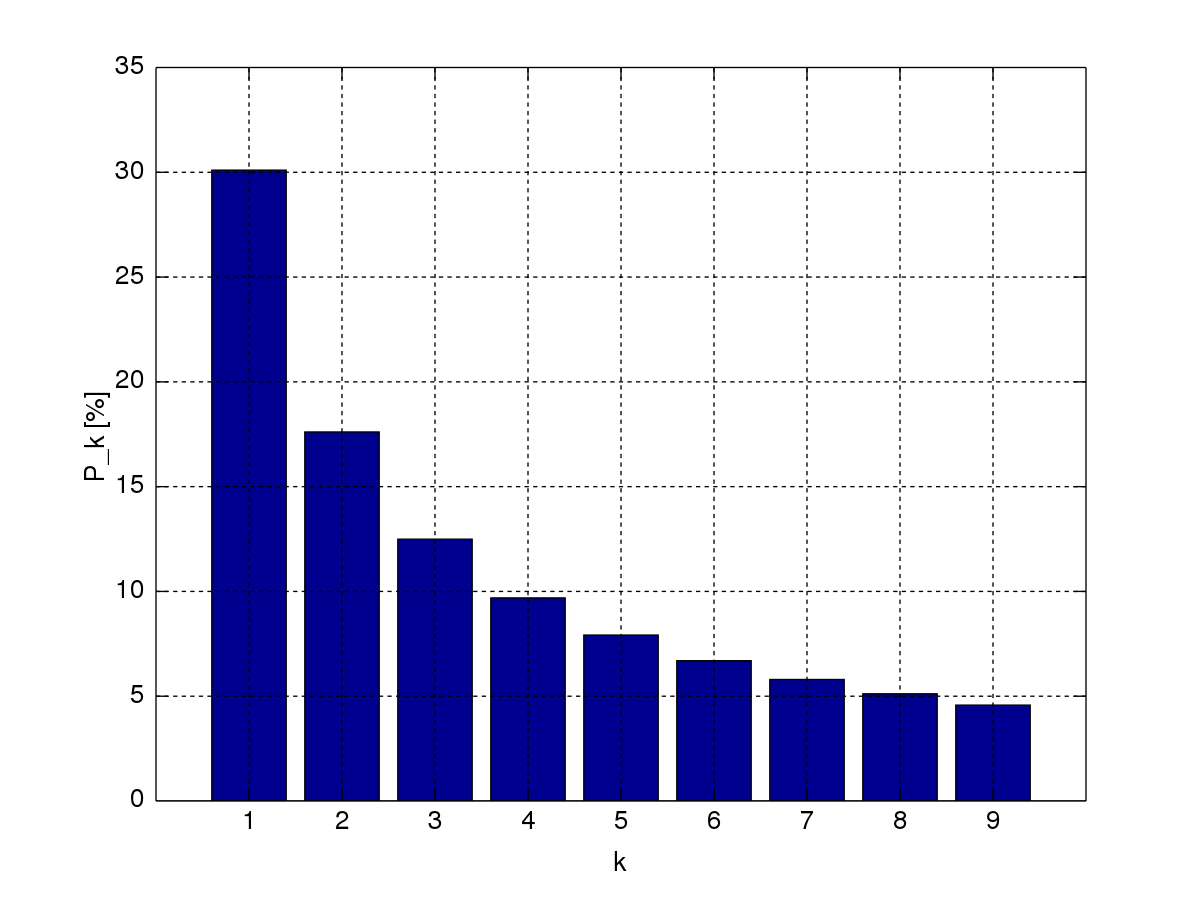

It has been observed that for a large set of numerical data, the frequency of the first digit of the numbers shows a particular distribution. It has been found number 1 occurs the most number of times. This accounts for 30.1% of all the values. The below table and the plot shows the distribution of other numbers.
Leading Digit Distribution as per Benford’s Law (Source: Wikipedia)[/caption]

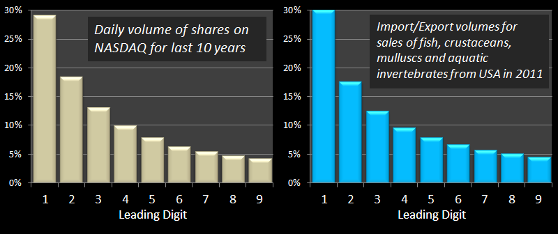

Real-life data that shows trends same as Benford’s Law( Source: https://datagenetics.com/blog/march52012/index.html)

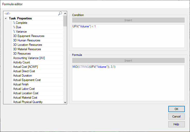

User Field Formula Used
· Volume:SUM(3D.CALCULATE_VOLUME)
· Leading Digit:LEFT(STRING(UFV("Volume")),1)
· Leading Digit (For modifying the values with ‘0’) :[UFV("Volume")<1]MID(STRING( UFV("Volume")), 3,1)

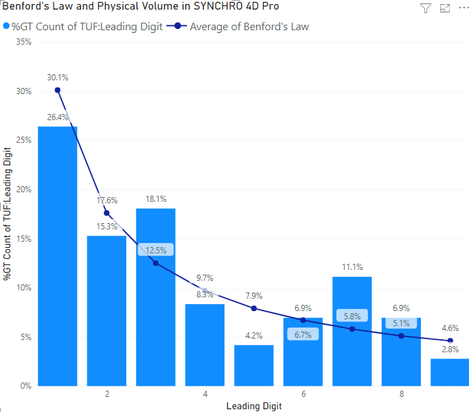

Result & Discussions
We can see the digit 1 as the most frequent digit and 9 being the least. This has some similarities with Benford’s Law. The total number of values considered was 72. If the number increases and may be for a larger project, we might find a closer resemblance with Benford’s Law.
