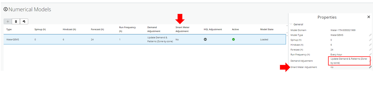

In the Administration Page >> Numerical Models  , once uploading a hydraulic model or when editing an existent model, there is the option to use smart meter adjustments or not. This option will only be available if the zone demand adjustment is set to System Total (Update Demand & Patterns Global) or Zone by Zone.
Fig1 - Enabling smart meter adjustment option
In case smart meter adjustment is set to No (this is the case for example when smart meter data is not available in WaterSight or the data is not reliable) the normal zone demand adjustments or system total demand adjustment method can be used. For more information please take a look at this article - Automatic Demand Adjustment.

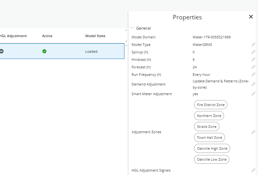

In case smart meter adjustment is set to Yes, WaterSight will use smart meter data (15 minutes or hourly flow - these are the minimum time steps required) to automatically adjust consumption and patterns of those smart meters in the model based on the real data. A remainder flow pattern - given by the difference of the total zone flow and the sum of all large customers flow - will be applied to the rest of all customers of the model that are in that zone.

Fig2 - Only the smart meters for the Listed zones (Fire District, Northern Zone, Straits Zone, Town Hall Zone, Oakville High Zone, Oakville Low Zone) will be considered when adjusting customer model demands.

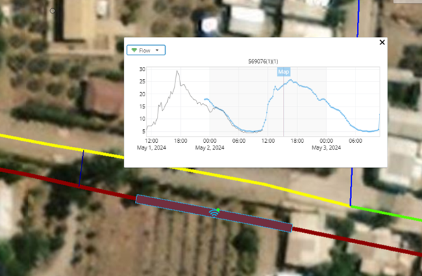

Fig 3- Comparing modelled flow with sensor flow (using the automatic demand adjustment option zone by zone)

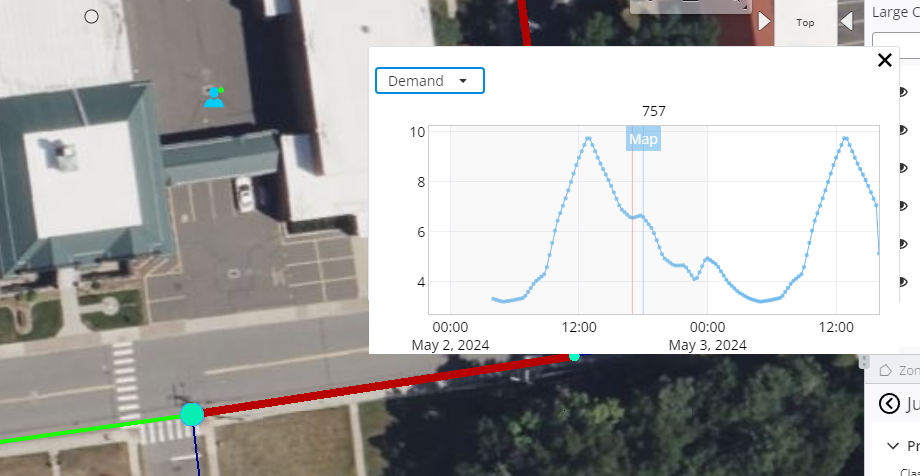

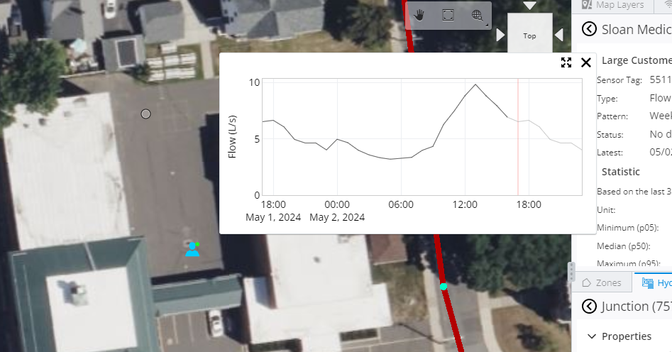

Fig 4 - On the left, modelled demand at the model junction near the large customer. On the right, smart meter flow from the large customer
Note: It should also be possible to also create a fictitious junction in the WaterGEMS model to represent that large customer, then create a SCADA element in WaterGEMS to represent that large customer and associate it with that junction using as attribute the demand. In that case it should be possible in WaterSight to click in the junction element and see in the same graph the modelled demand and measured flow. However please make sure that by creating this fictitious junction you are not duplicating the customer demand in the model.
