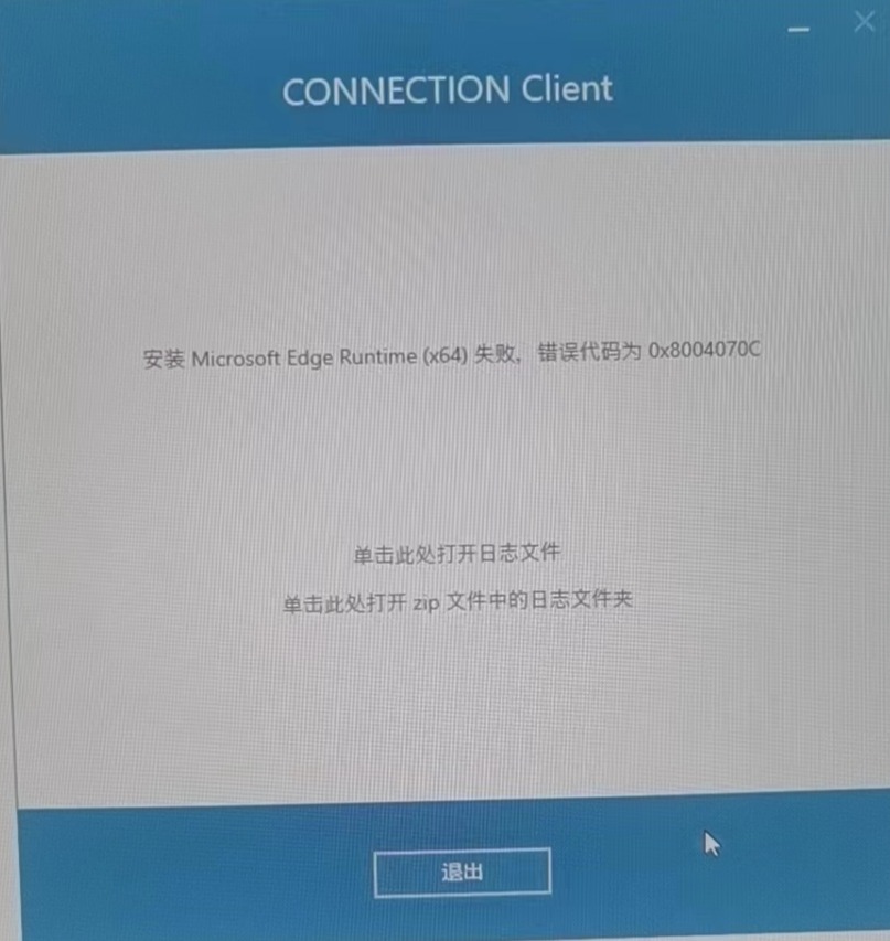

问题描述:
安装Connection Client提示:安装Microsoft Edge Runtime(x64)失败,错误代码为0x8004070C错误
A computer screen with a blue and white screenDescription automatically generated

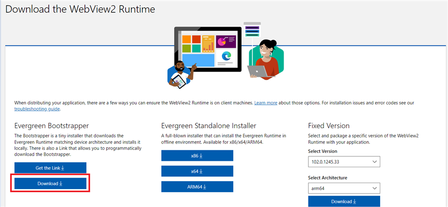

无法通过Connection Client安装Microsoft Edge Runtime(x64)时,需要在官网下载Microsoft Edge Runtime(x64)安装包,成功安装后再尝试安装Connection Client.
1.请打开https://developer.microsoft.com/en-us/microsoft-edge/webview2/ 下载安装Evergreen Bootstrapper。
