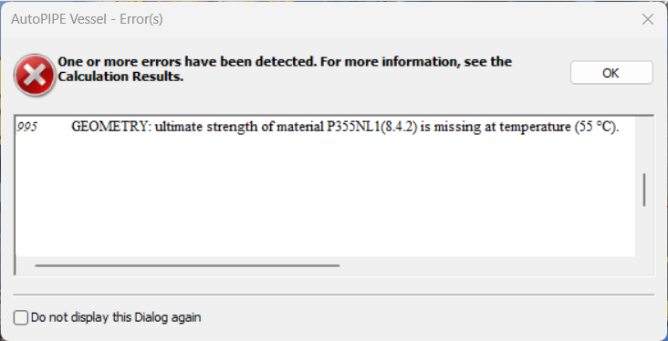

Error Code 995 - GEOMETRY: ultimate strength of material P355NL1(8.4.2) is missing at temp (55 °C).
Product(s):AutoPIPE Vessel
Version(s):45.00.00.133
Environment: N/A
Area: Error

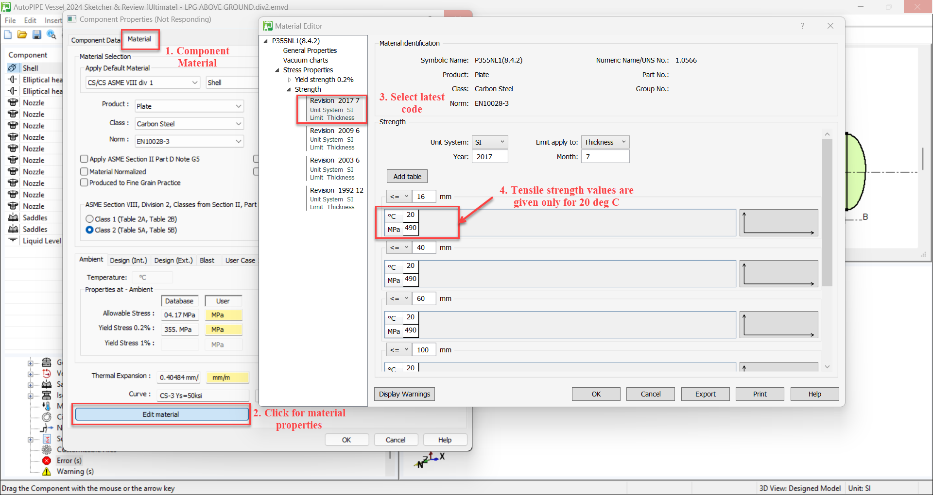

The following occurs when I perform the Strength Calculations:
Errors:
Error Code 995 - GEOMETRY: ultimate strength of material P355NL1(8.4.2) is missing at temperature (55 °C).
How to fix it?
Answer:
This error generally occurs if the material properties are not available at design temperature in the code hence in the software database.
Open the component properties by double clicking on it and follow the steps given below to check if properties are available for design temperature,
  1. Go to the material tab
  2. Click on the Edit Material option
  3. Select the material tensile strength section with latest code edition
  4. Check if tensile strength values are presents for design temperatures.
In case your model has design temperature 55 deg C but properties are available only for 20 deg C, then you will face this error.
Workaround : use another material or change the temperature (no issue at 20 °C).
