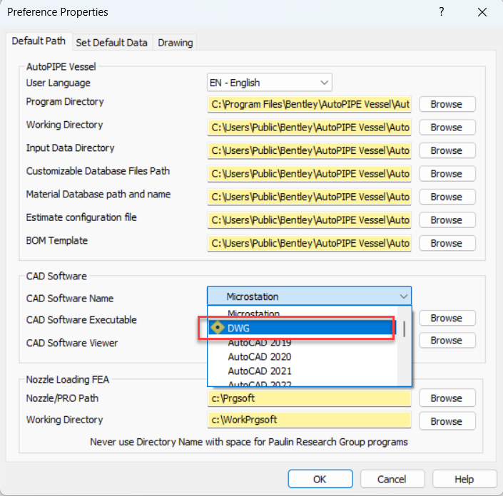

AutoPIPE Vessel 2024 (45.00.00.133) has a bug and users cannot use the “Move to production” and “Generate drawing” for AutoCAD 2019, 2020, as well as BricsCAD 2022 and 2023.
But we can still generate the drawings through AutoCAD 2022 & 2024.
We recommend you to choose DWG option from File>Preferences>CAD Software Name.
A bug has been already created and we are working on fixing this issue. The corrected feature is made available to you in a new version of the software.
