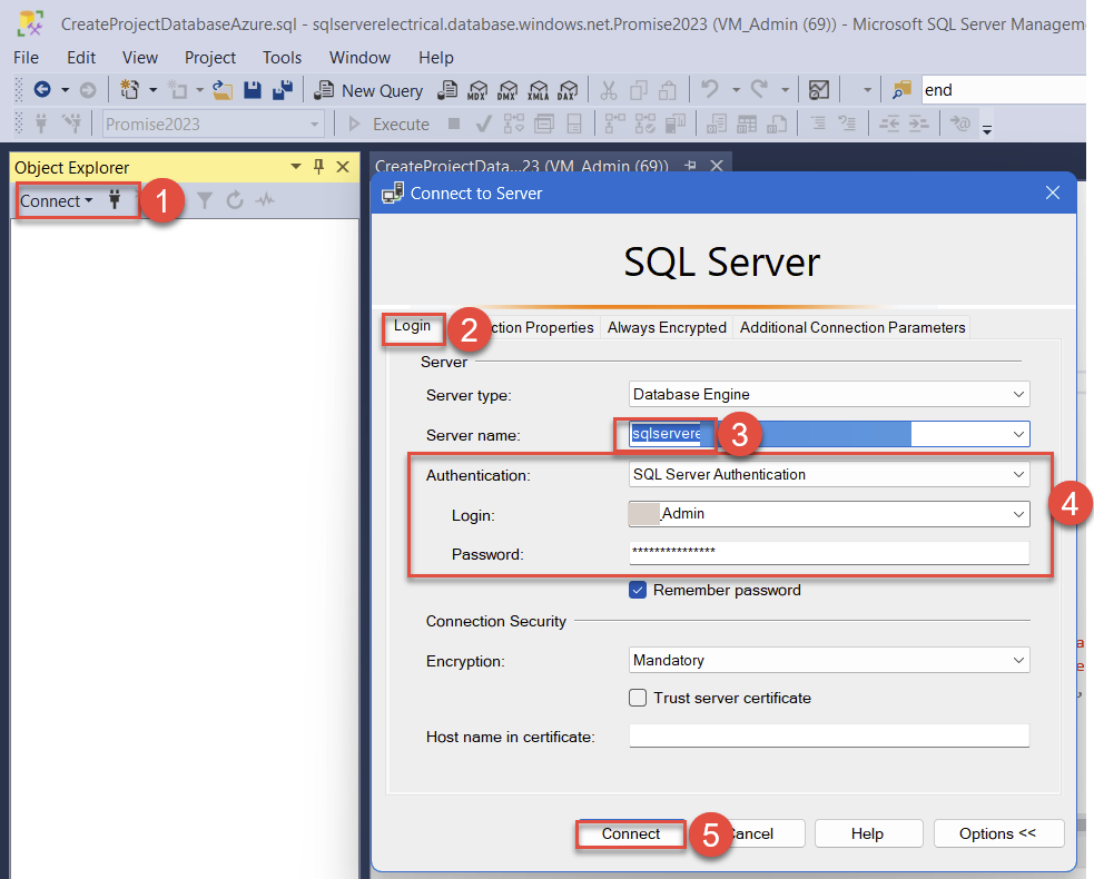

  2. Next open SQL Server Management Studio and connect to the Azure SQL Server.

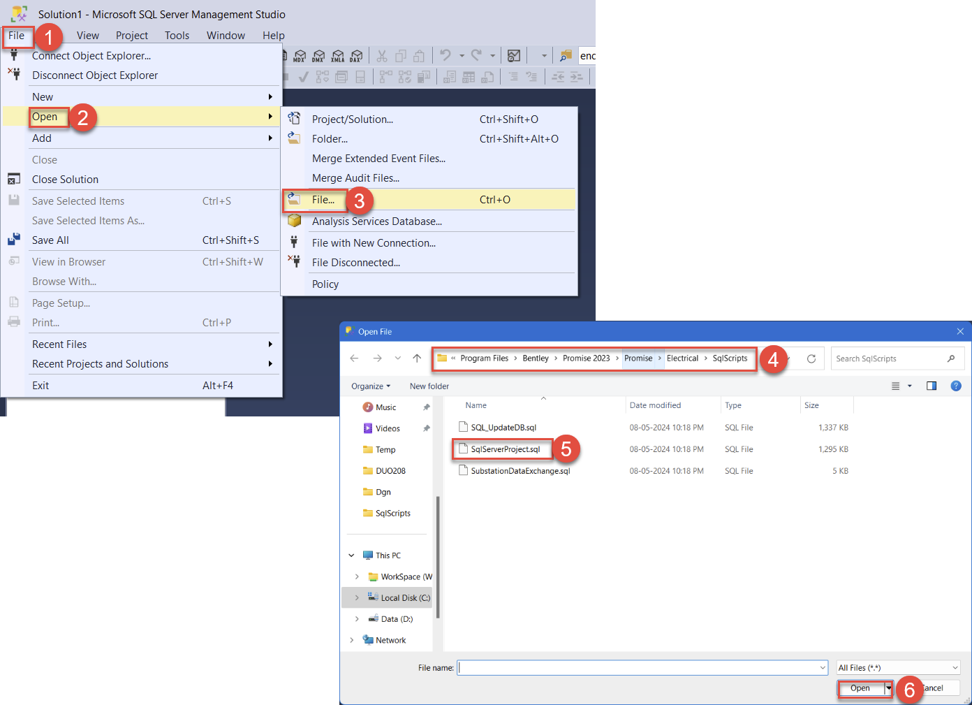

  3. Select the script by File >> Open >> File >> Browse to "C:\Program Files\Bentley\Promise 2023\Promise\Electrical\SqlScripts" >> select SqlServerProject.sql >> Open.

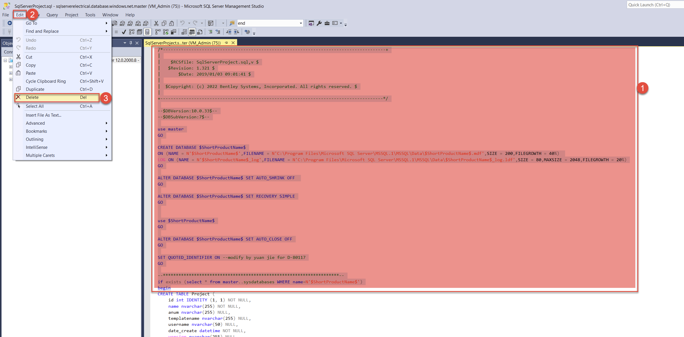

  4.  In the query dialog select and delete all the script before the "Create Project Table" line as highlighted in below screen shot.

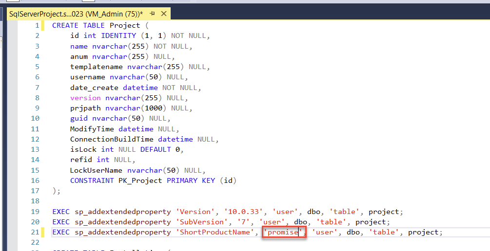

  5. Change the "$ShortProductName$" text to "promis.e" (do not include the double quotes).

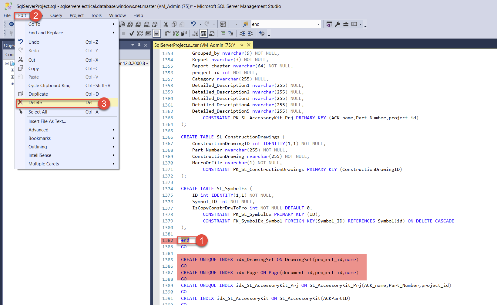

  6. Next find the "end" using Find for searching it  until you reach one above the query "Create Unique Index ..." or go to line number 1382. Select the "end" and delete it as seen in below screen shot.

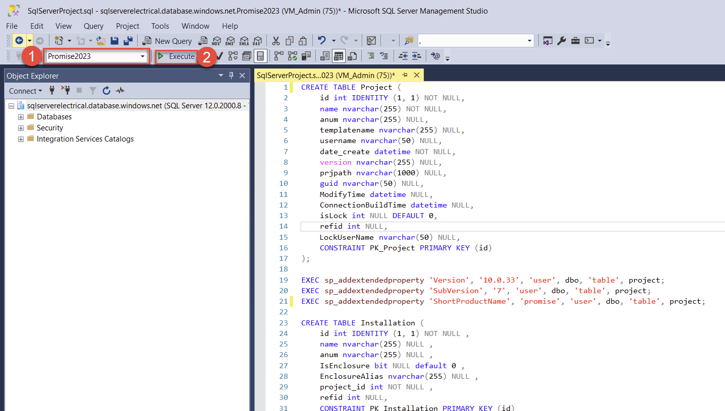

  7. Make sure the Active Database is set to Database create in Step 1 to be used for Project Database. Then select "Execute" to run the query.
