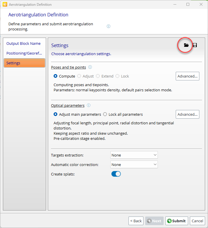

iTwin Capture Modeler includes some Presets (low level settings) that control all aerotriangulation processing settings which can help to improve the results of the aerotriangulation under specific conditions.
The presets can be accessed from the Settings section of the Aerotriangulation Definition dialogue as shown below:
A screenshot of a computer
When you have clicked o the icon you will need to navigate to the following location depending on which edition of iTwin Capture Modeler is installed:
ITwin Capture Modeler:
C:\Program Files\Bentley\iTwin Capture Modeler\data\Presets\AT
iTwin Capture Modeler Center
C:\Program Files\Bentley\iTwin Capture Modeler Center\data\Presets\AT
