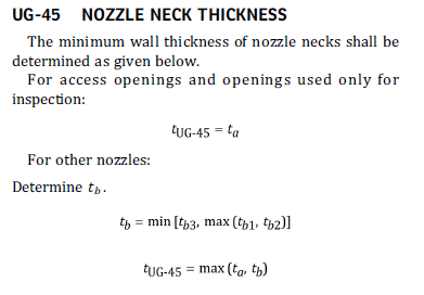

To understand nozzle neck thickness requirements, refer to ASME BPVC Section VIII, Division 1, UG-45. This section specifies the minimum wall thickness for nozzle necks and related components.
UG-45 Overview:
Definitions
  1. ta: Minimum neck thickness required for internal and external pressure using UG-27 and UG-28 (plus corrosion and threading allowance), as applicable.
    • External forces and moments from supplemental loads (UG-22) must be considered. Shear stresses caused by UG-22 loadings shall not exceed 70% of the allowable tensile stress for the nozzle material.
  2. tb1: For vessels under internal pressure, the thickness (plus corrosion allowance) required for pressure (assuming E = 1.0) for the shell or head at the location where the nozzle neck attaches.
    • Use the parent component radius (shell/head) in the UG-27 formula instead of the nozzle radius.
    • Must not be less than the minimum thickness specified in UG-16(b).
    • Use vessel corrosion allowance (Cav) instead of nozzle corrosion allowance (Can).
  3. tb2: For vessels under external pressure, the thickness (plus corrosion allowance) obtained by using the external design pressure as an equivalent internal design pressure (assuming E = 1.0) for the shell or head at the nozzle location.
  4. tb3: Thickness given in Table UG-45 plus corrosion allowance.
  5. tUG-45: Minimum wall thickness of nozzle necks.

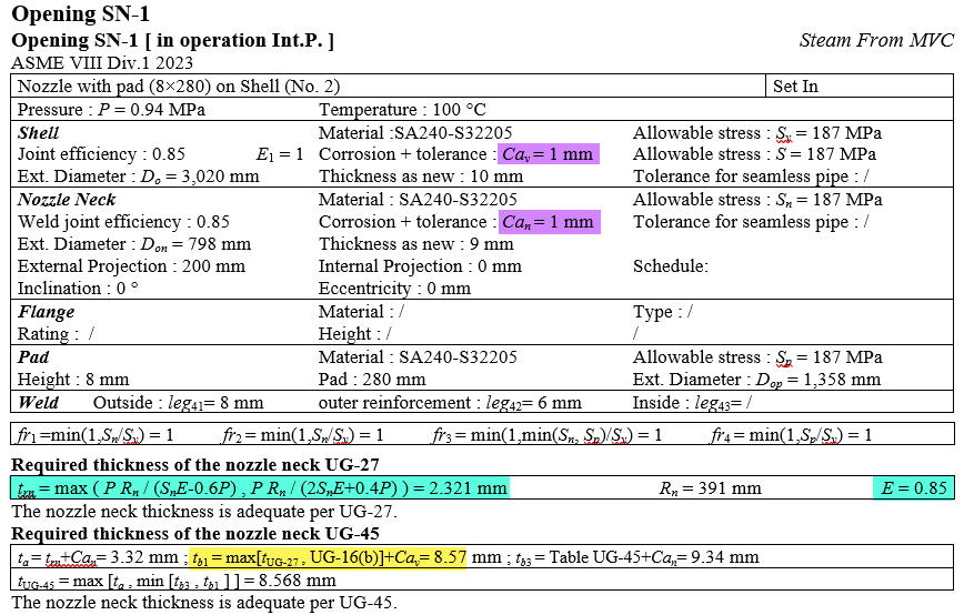

Example:
Steps:
  1. Calculate ta using UG-27 for internal pressure, considering nozzle material and corrosion allowance.
  2. Calculate tb1 using shell/head radius and assuming E = 1.0.
  3. Compare ta, tb1, tb2, and tb3 as per UG-45 rules.
  4. Final nozzle neck thickness = max(ta, tb).
