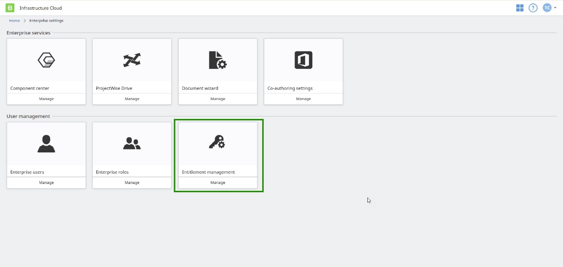

Entitlements are granted/assigned at the Enterprise Level which can be accessed through Enterprise Settings – Entitlement Management.
Bentley’s policy is to set the Default Access configured at the Entitlement/Licenses Management service for every application as Allowed, meaning all users in an Organization are entitled to use any Entitlement.
If Everyone is granted access to Bentley Infrastructure Cloud Connect and Bentley Infrastructure Cloud ProjectWise, all users who access a Bentley Infrastructure Cloud project in their organization, will consume a Bentley Infrastructure Cloud ProjectWise entitlement disregarding the role assigned at the project level

Before you start adding participants to Bentley Infrastructure Cloud projects, the Best Practice is to configure entitlements at the Enterprise Entitlement Management.
