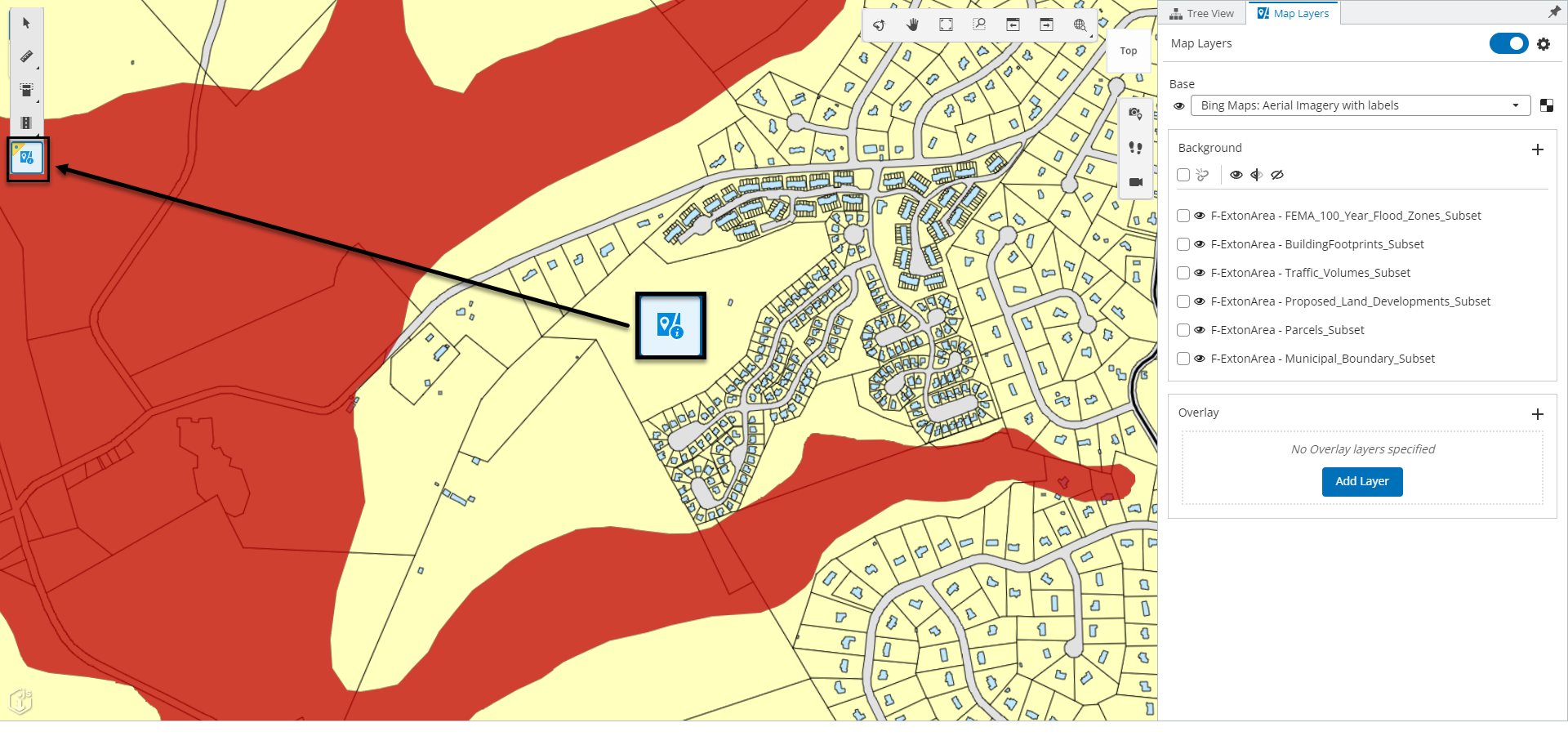

When an ArcGIS Map layer or a Feature layer is attached to the view, the Map Layers Info tool appears in the tool bar on the left hand side. You can select the tool and click on the geometry you want to access the properties. This tool works only with ArcGIS layers.

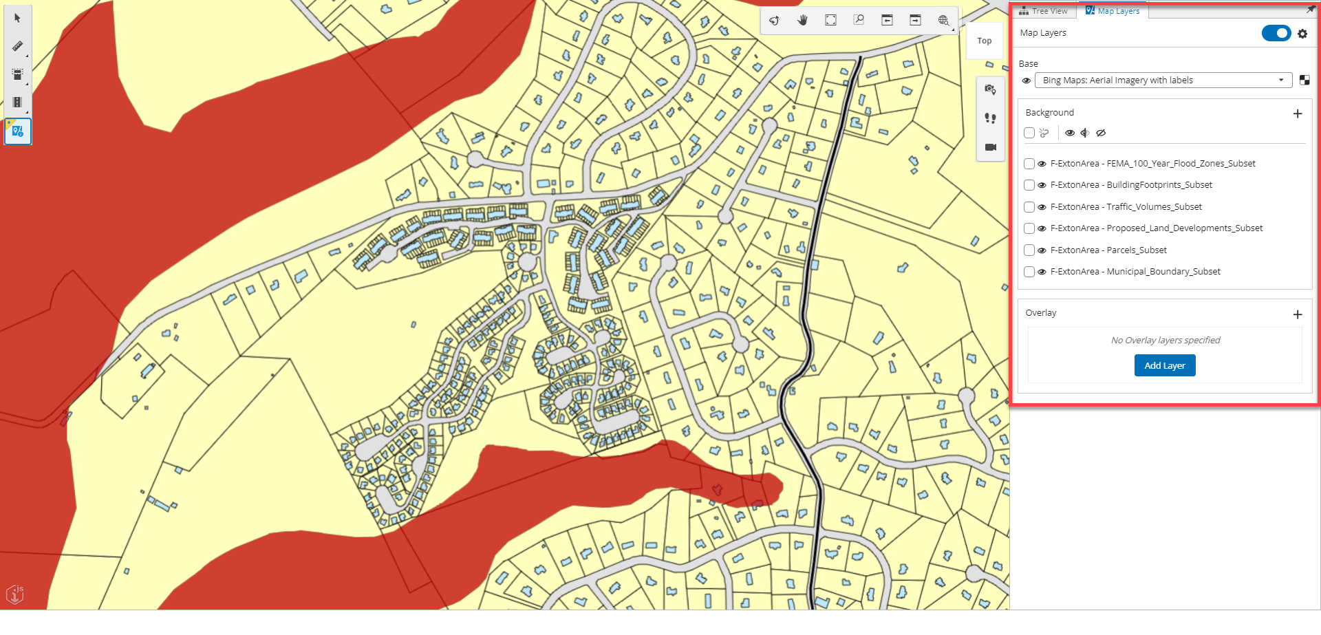

Attach your layers to the Map Layers widget.
Click on the Map Layers Info tool and select a geometry.

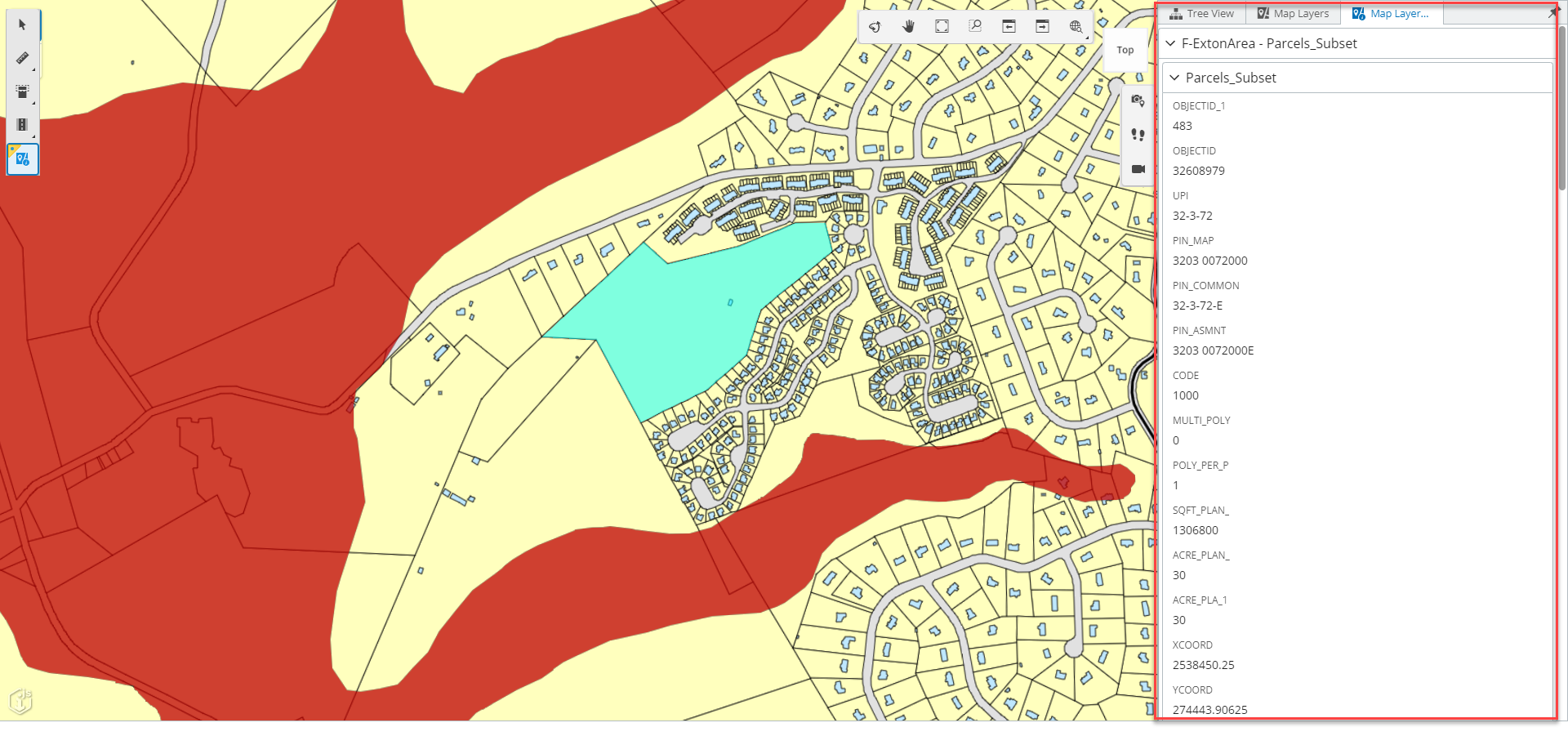

The geometry is highlighted in light blue and the properties are displayed on the right, in the Map Layers Info panel.
The properties panel displays a single feature at a time.

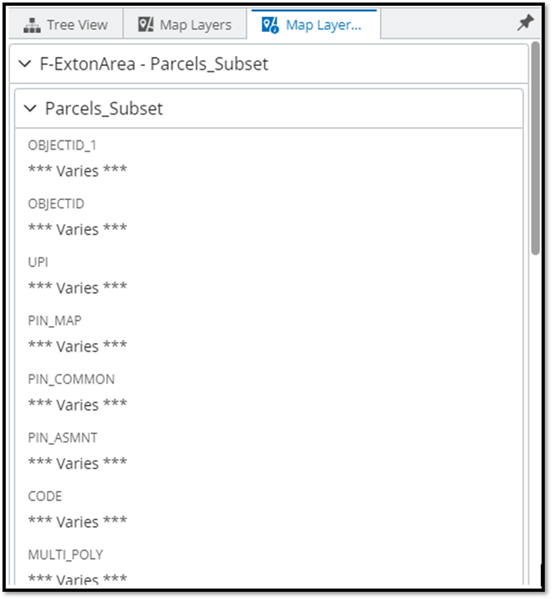

If you are at a higher zoom level, your datapoint may hit more than one geometry. When the data point hits polygons or lines, the value "***varies***" will be displayed because the tool has not been able to return any property. You must zoom in and select a single feature.

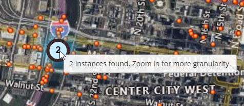

Point feature type
If the data point hits multiple point features, a cluster is displayed, showing the number of features selected and a tooltip suggesting zooming in for more granularity.

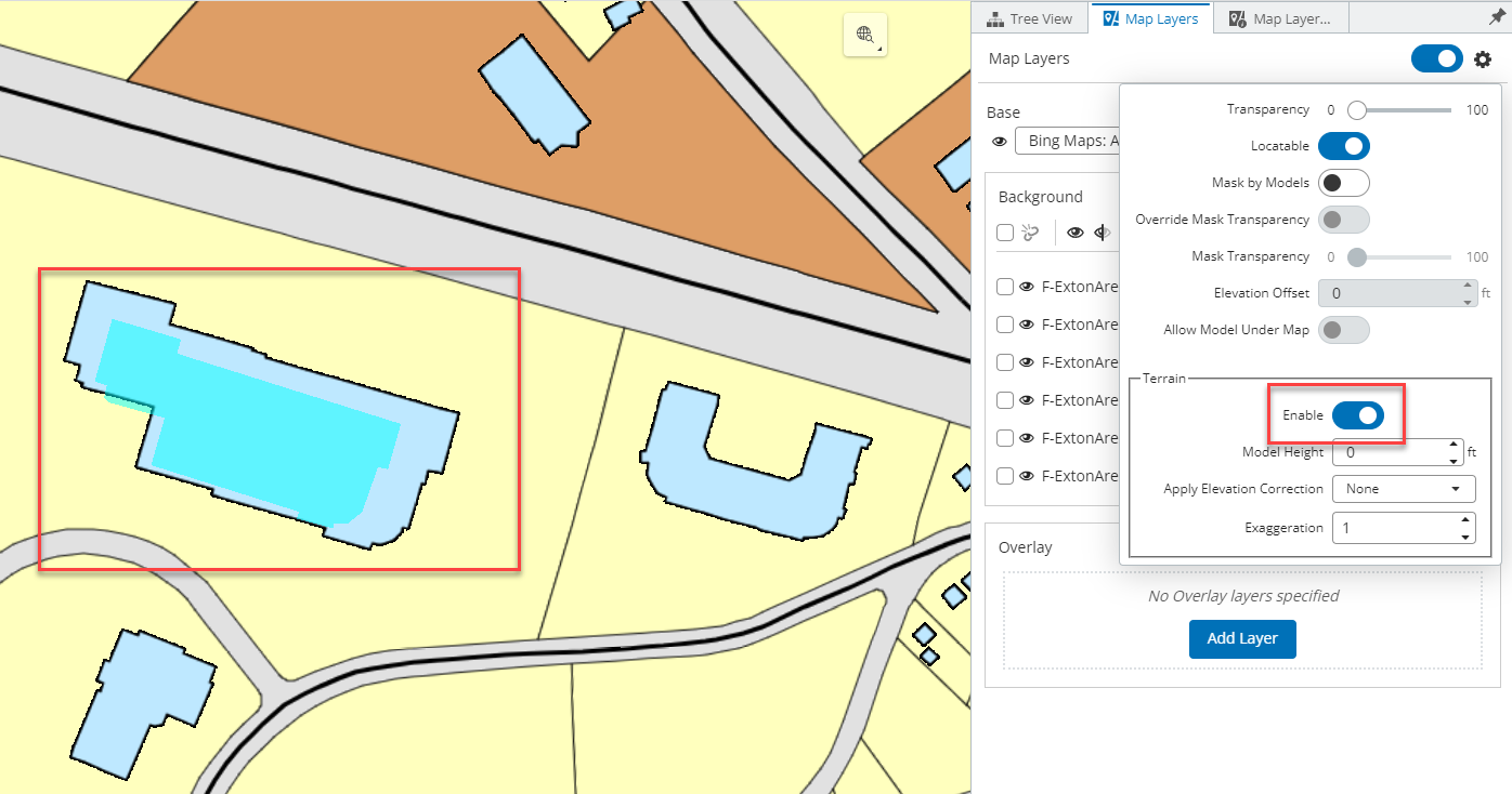

When the Cesium Terrain is enabled in the view, the geometry selection may not be good. You may see the highlighted geometry shifted compared to the real geometry. Because of this we suggest that you disable the Cesium Terrain when using the Map Layers Info tool.
