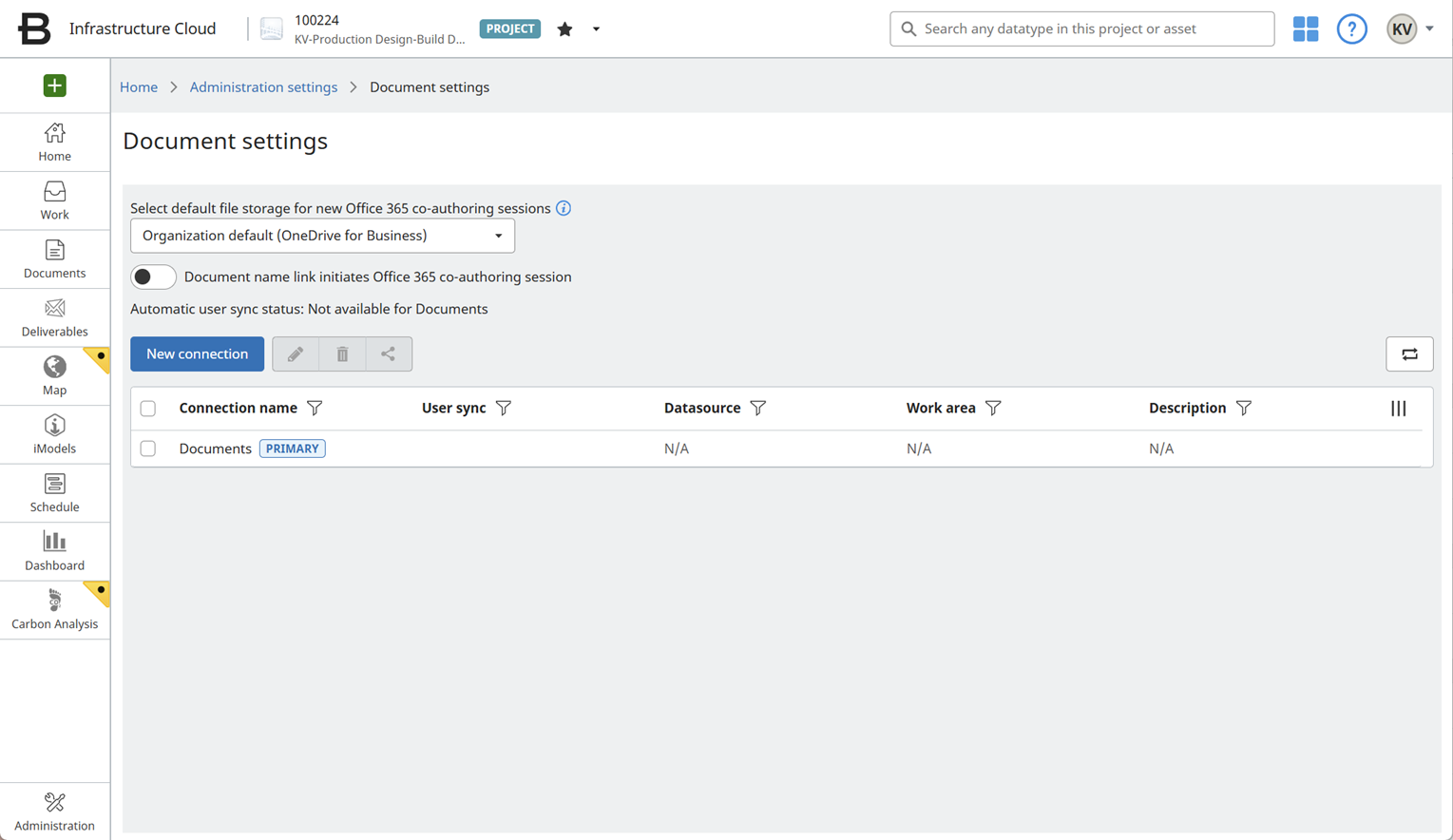

Select Administration Document Settings to create or modify a work area connection.
The Document settings panel will show the existing document connections and their options for the project. The default Documents storage is shown as Primary.

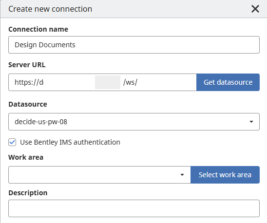

Create a New Connection
To create a connection to an existing ProjectWise Work Area, click on the New connection button.
Select Server and Datasource

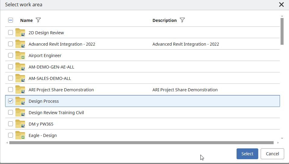

Select Work Area

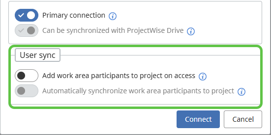

User Synchronization Setting
When creating a work area connection, users can choose to sync participants form that work area that are set in ProjectWise Explorer.

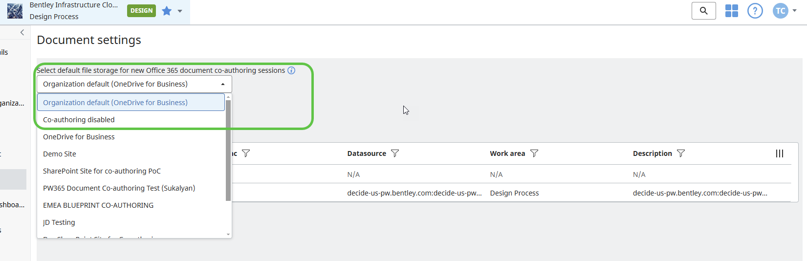

Office 365 co-authoring setting
Project Owners can select the default storage for new Office 365 document co-authoring sessions or Sharepoint sites configured for co-authoring.
