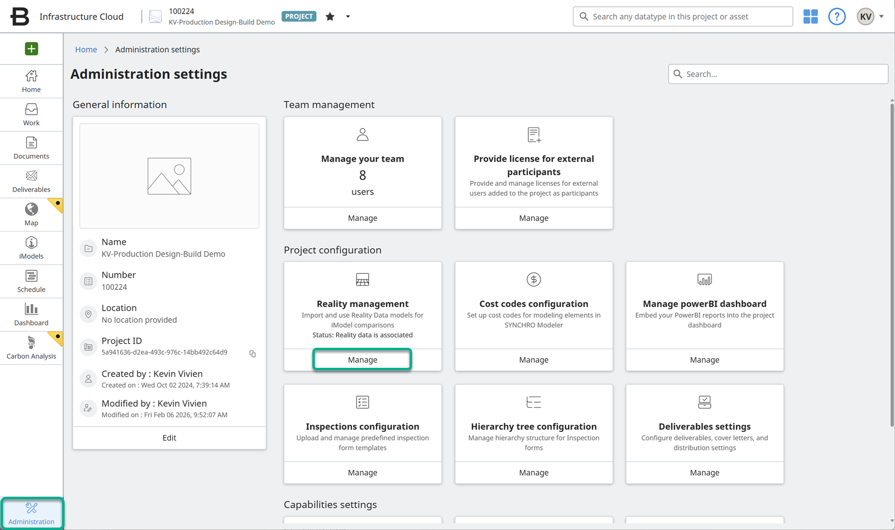

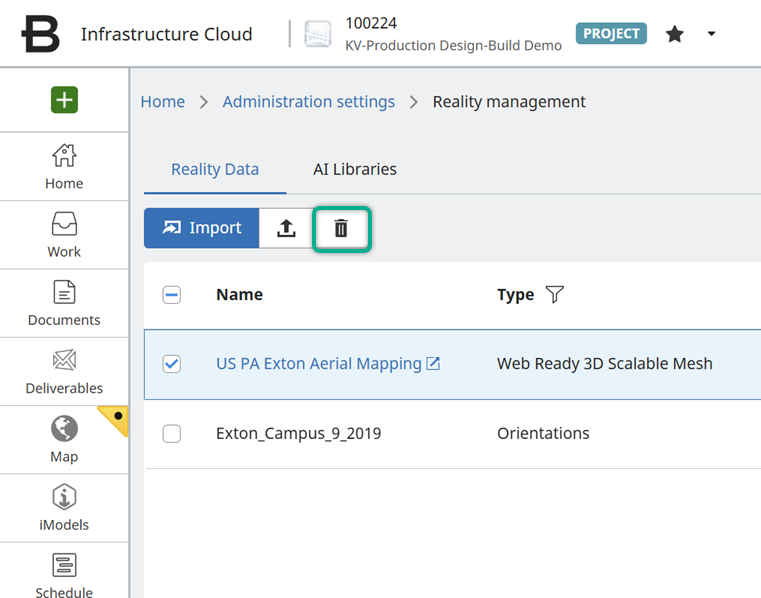

You can link Reality Data to the project from under Administration > Reality management

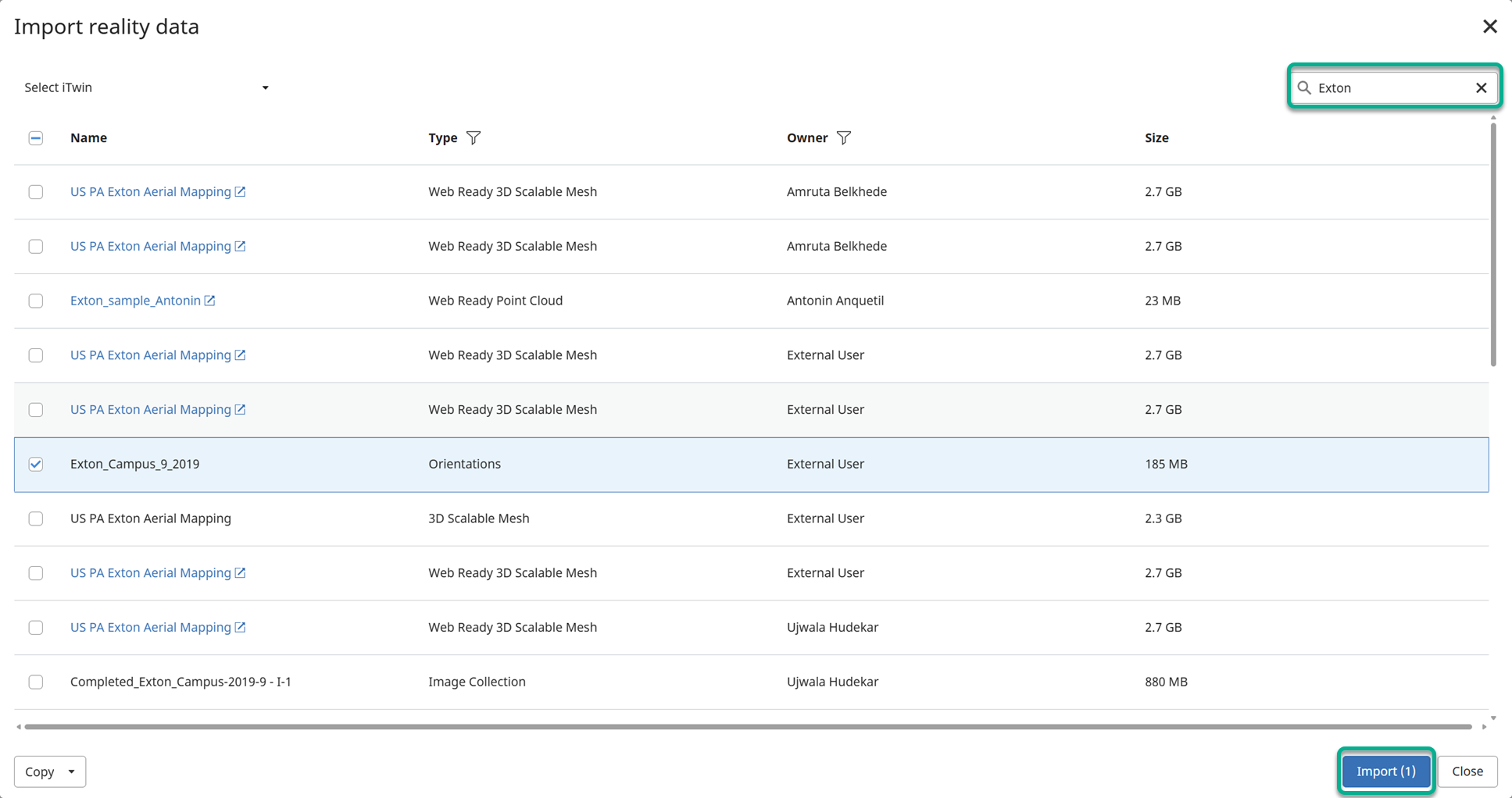

If you already have access to PW ContextShare, you can Associate an existing Reality Data
1 – Select Associate
2 – Search for the desired Reality data
3 – Select the Reality data
4 – Click on Associate

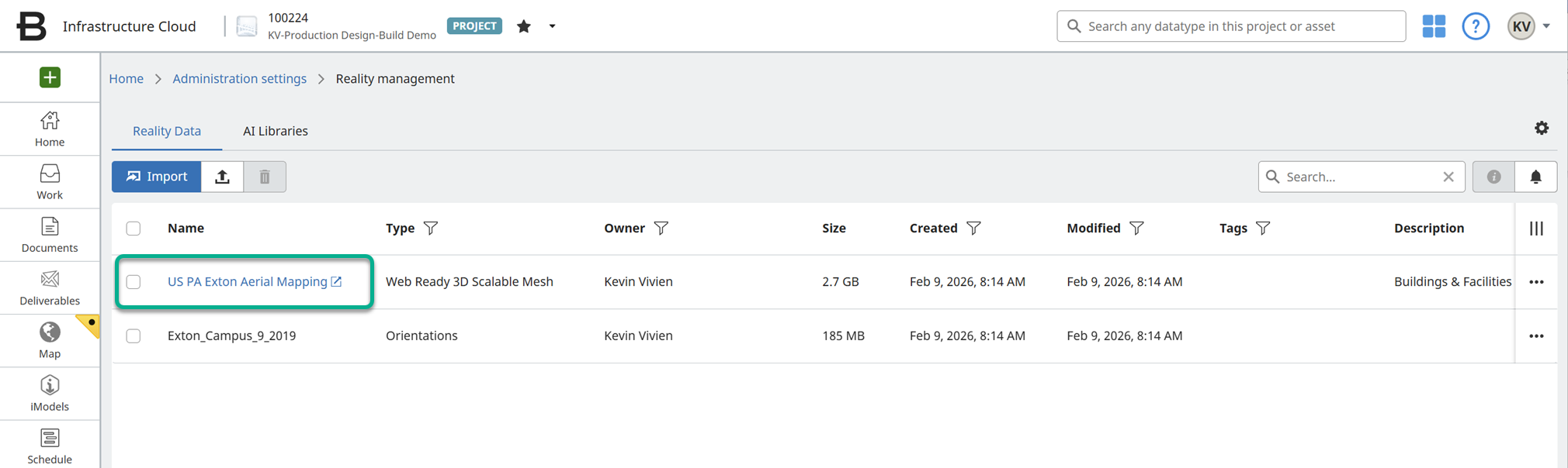

This will make the Reality Data available for all iModels in the project.
If the Reality Data has been processed and is web-ready, it will be highlighted as a blue link and upon selection will open the model in the reality data viewer.

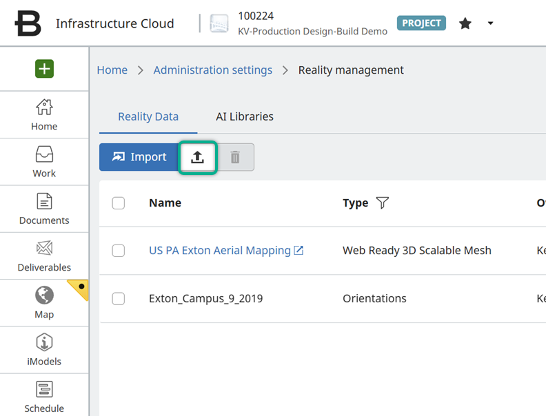

To create a new Reality Data, the best practice is to use iTwin Capture Import & Upload tool.
This is a free tool that can be downloaded from here -https://softwaredownloads.bentley.com/en/ProductDetails/3115
Refer to the following wiki for best practices on optimizing and uploading Reality Data -  Optimizing & Uploading Reality Data for iTwin
Additional Options

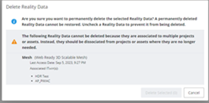

Dissociates selected Reality Data but does not delete it from Reality Data Manager.
Permanently deletes selected Reality Data.
It will give you a warning before doing so, with a list of all projects that are associated with it.
 Provides directions on downloading selected Reality Data.

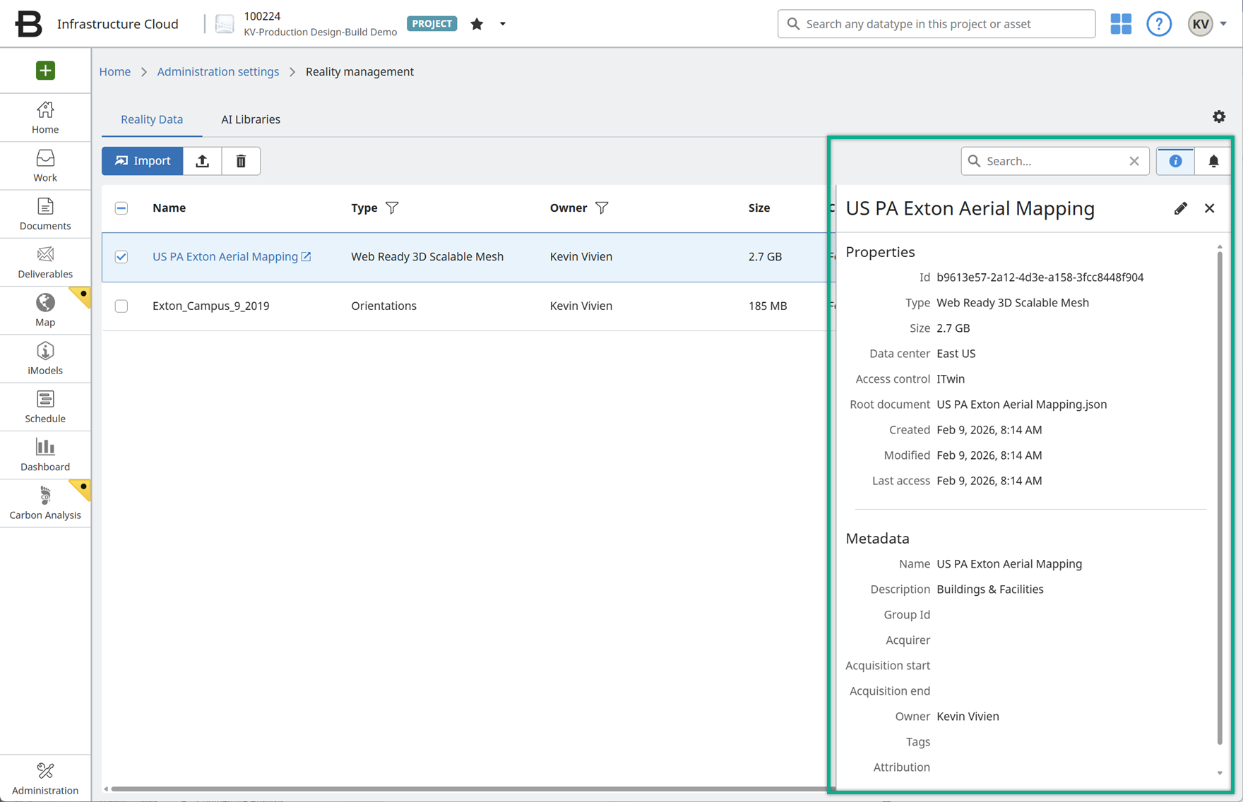

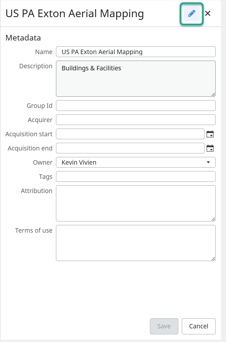

 Shows information about the selected Reality Data.
Some of the parameters like NameOwnersAccess ControlAcquisition Start/End, and Description can also be edited
Access Control has to be set to public so everyone can see the Reality Data
