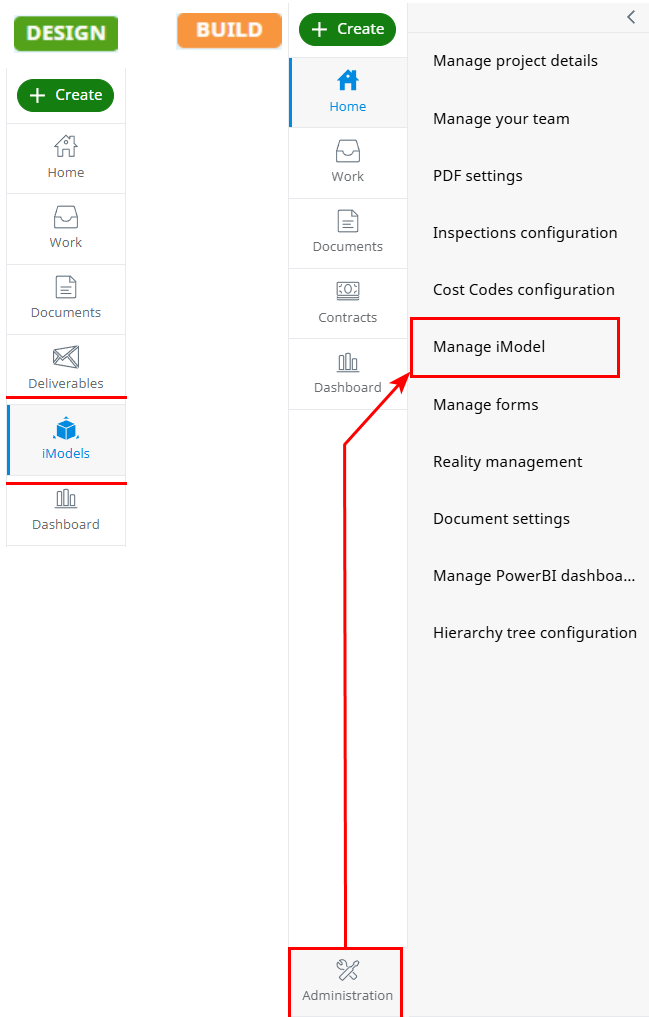

1. Accessing the iModel Manager
Depending on the template selected when creating the iTwin, you will either be in a Build iTwin or a Design iTwin. For a Design iTwin, the iMdeol Manager icon will be in the toolstrip on the left side of the portal.  For a Build project, it will be under the Administrator tools icon which opens a secondary menu.
This takes you to iModel Manager. This lists all the iModels in your project and allows you to perform different actions on them.

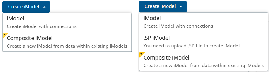

2. Create an iModel
To create a new iModel, click on the blue "Create iModel" button at the top left of the iModel Manager page.  This button will have differnt drop-down menu options depending on whether you're in a Design or a Build iTwin project.
The following steps outline creating an iModel from Design files.  For steps on creating a Composite iModel look here. For creating an iModel from a SYNCHRO Pro .sp file look here.

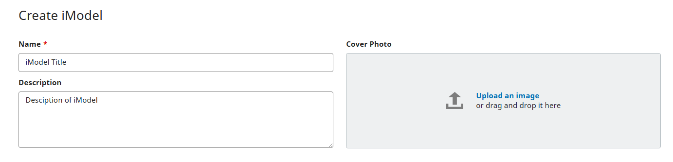

3. iModel Title and Description
Give the iModel a title (required) and optionally type a description and\or upload an image to differentiate it from other iModels  When finished, click the Create button.

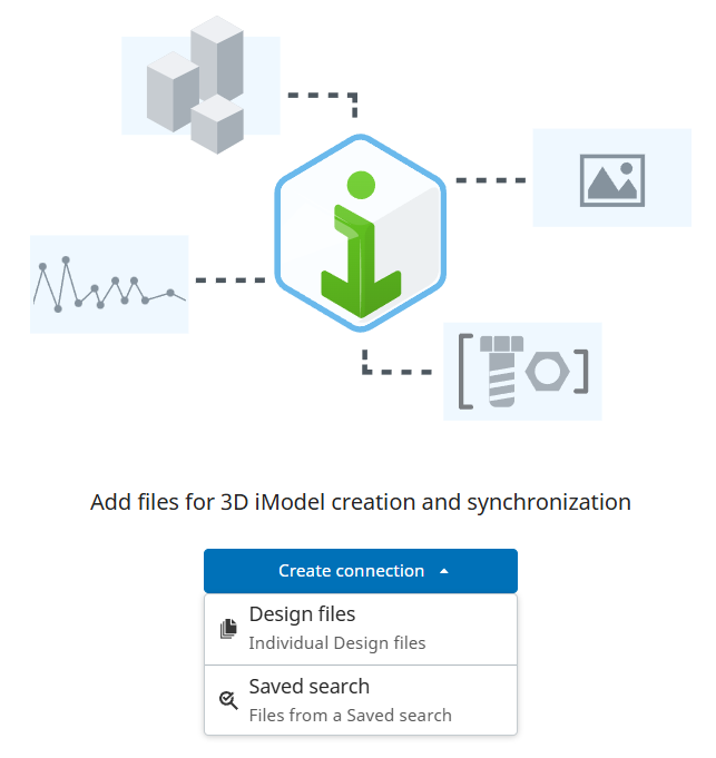

4. Choose the Connection Method
The next page allows you to create connections for synchronising CAD file data to the iModel.
At this stage, you can choose to populate your iModel by creating a Connection for:

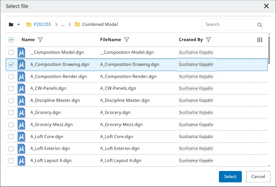

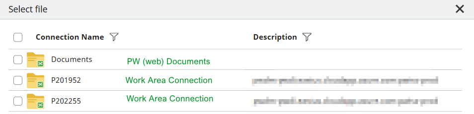

When selecting the Design Files option, the user is presented with a set of folder options from the Documents section of the Infrastructure Cloud Design project. You can select from any PWDI Work Area Connection, or select from the delivered PW web Documents folders (these are the folders typically used with PW Drive).
If the user selects the "Saved Search" option, then ONLY PWDI Work Area connections will be displayed, as the web-based PW Documents do not have Saved Search capability.
[Note: See the next section on Saved Search Considerations]
You can select multiple files if necessary.  In the example below, the user selects a single design file (which has references) from a PWDI Work Area connection and clicks the Select button.

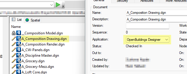

If selecting from a PW DI Work Area Connection, the application association is read from PW to determine a "best guess" for the iModel Connector:

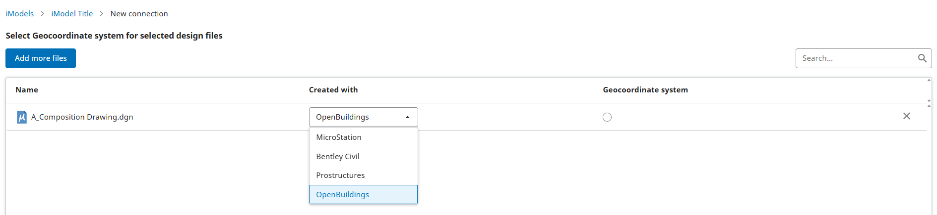

Note that the Connector is selected by default based on this information, but the user can change it if there are other possible connectors as in the above example for a DGN file. If for example it were an IFC file there would only be a single option: the IFC Connector.
Note: If selecting from the delivered PW web Documents area, there is no application association, and the user will need to manually select the connector.
Next the user needs to select a file to be used as the geospatial root for this iModel.  Every iModel needs to have a geocoordinate system defined before elements can be written to it.  If one is not supplied, the very first file sycnhronised is used.  In that case, the Next button will not enable until a file with a geocoordinate system is selected.
Often this can (and should) simply be an empty DGN file used just for geolocation purposes. Note that if a file containing elements in it is chosen as the file with the geocoordinate system, that file cannot be unmapped (removed) afterwards.  By using an empty DGN with the geolocation in it, the user does not need to worry about that file needing to be unmapped.

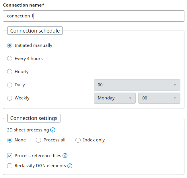

Connection Schedule and Settings
The next step is to define a connection name , set the sycn frequency and configure settings for the connection.
When finished, this connection can be found on the main Connections page.

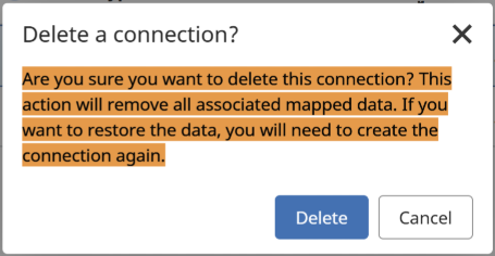

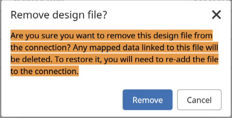

Notes on editing connections:
Previously when removing a connection, or removing a file within a connection, the user would be prompted to either keep previous changes or remove all data associated with the file.
The first option to keep the previous sync'd data has been removed, and the user is now presented with a single message informing the user the data will be removed, and if needed can be restored by recreating the connection or adding back the removed file.
This change is required to reduce the amount of orphaned models within iModels
