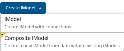

Bentley's Infrastructure Cloud currently has 2 ways of accessing project CAD files for use in creating iModels.
In both cases, the user starts with creating an iModel with the Create iModel button. There are 2 options for creating a standard “Connected” iModel (using connections) as well as a tech preview for “Composite” iModels (iModels from iModels)
A screenshot of a computer
AI-generated content may be incorrect.
After creating a Connected iModel (1st option) the user is asked to populate it by selecting design files, or (in the case of a ProjectWise Work Area Connection) Saved Searches stored in PW Design Integration server.
In the case of selecting design files, the user can use the delivered PW Web Document provided with the iTwin template, or select from a Work Area Connection as outlined above.
