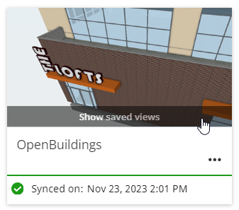

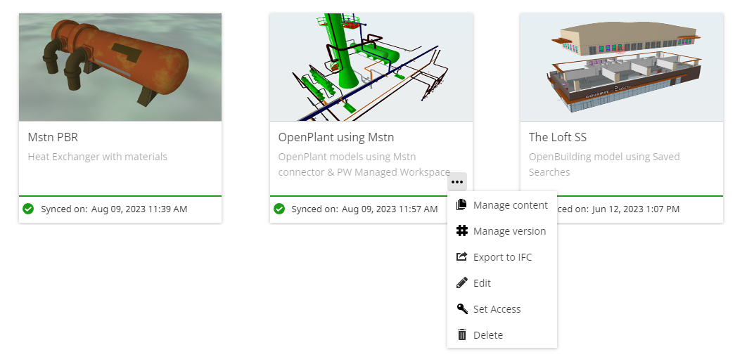

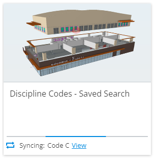

When selected, the user is presented with all iModels for the associated iTwin as a collection of tiles.  These tiles display an optional user-supplied image, a required name, a "3 dot" context menu (accessed by hovering over the bottom right part of the main tile) and a Sync status bar.
Note the Sync status bar does not appear for users with "Manage" entitlement.

More information on the iModel context menu can be found here.

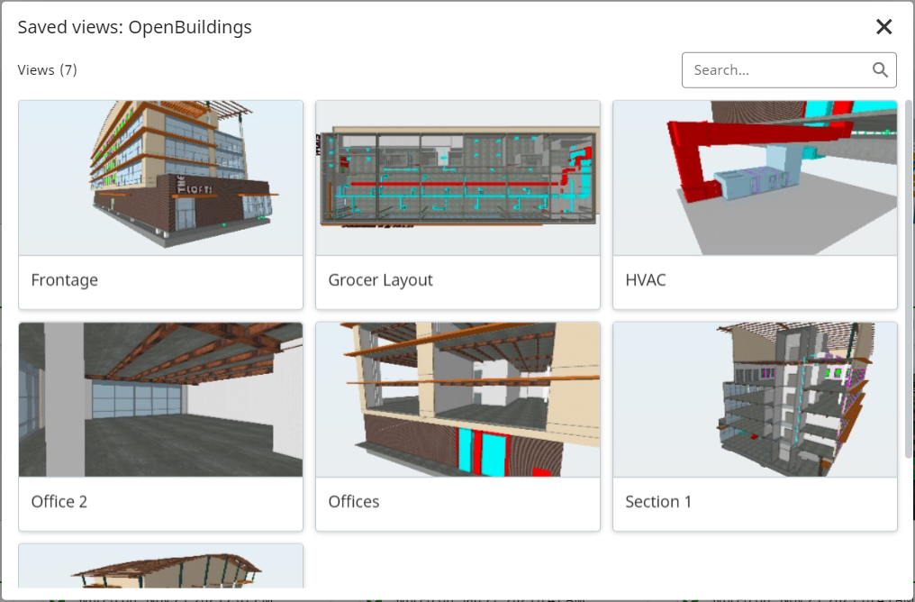

In Tile view, when hovering over the lower part of the iModel image tile, a highlighted band labelled "Show saved views" will appear.
In List view, this is a link on the right hand side of the iModel row.
Clicking on this band will open a sub-panel with a list of saved views for that iModel:
Clicking any of the saved views will open the iModel in the viewer with that Saved View active.

Sync Status Bar
The Sync status bar includes information about the last run Sync connection.  If a connection is running it will show the words "Syncing: " followed by the name of the connection currently being processed.
Once again, the status bar only appears for users who belong to roles which have Engineer or Validate entitlements.  Roles with Manage entitlements should not see the status bar.

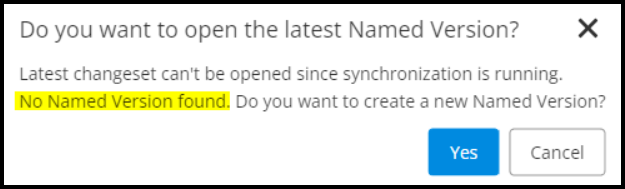

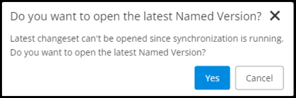

If a Connection is running (as in the image above), the user will be prompted to open a Named Version:
If no Named Version exists, the user will be asked if they wish to create one:

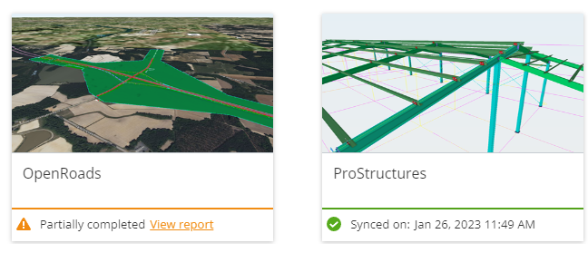

If the last Connection to run has a Partial Success or Failure status, it will be reflected in the status bar along with a link labelled "View report".
Clicking the "view report" link will take the user to the Connections page highlighting that specific Connection.

If the last run Connection completed successfully, it will be reflected with a green checkmark and the date & time of the last run.
