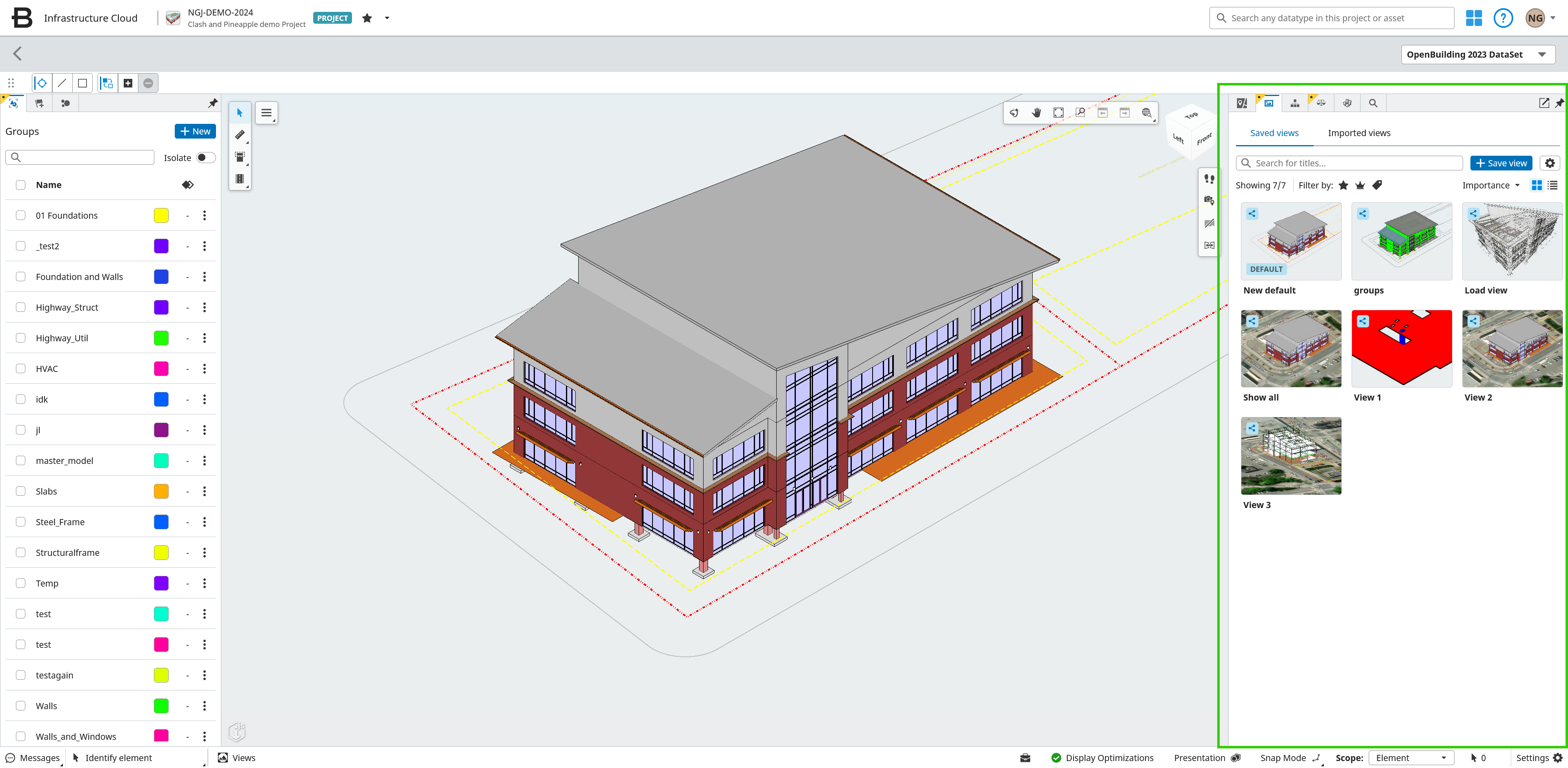

Opening the Widget
Above shows the default position of the Saved Views widget.

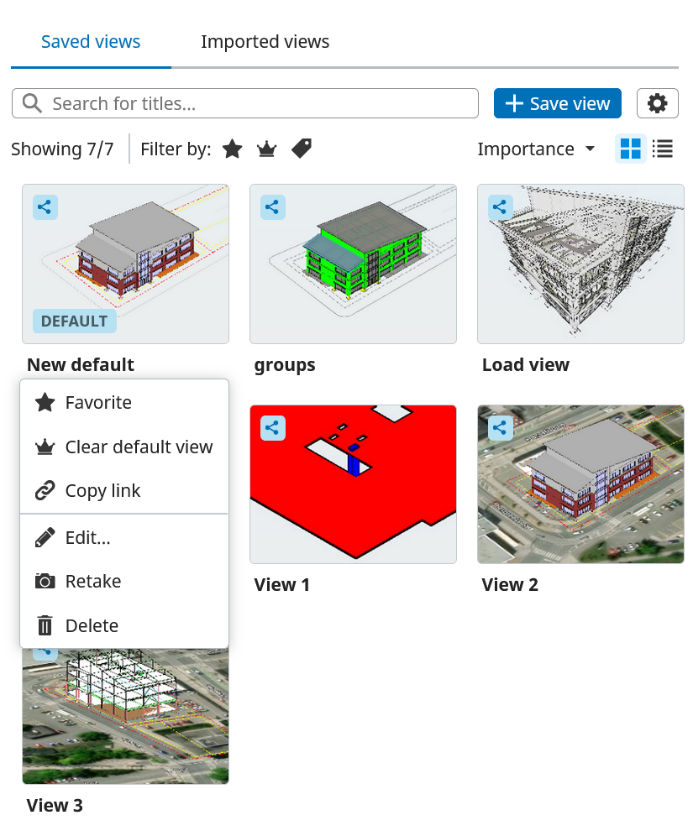

Options Menu Actions
Click the ⋯ button on any tile to access these actions:
Action
What it does
Apply View
Applies the saved view to the current viewport using the selected apply mode.
Rename
Edit the view name inline.
Delete
Permanently removes the saved view.
Share / Unshare
Toggle sharing with all project members.
Set as Default
Marks this view as the iModel default view, applied when the model is first opened.
Add / Edit Tags
Manage the tags associated with this view for filtering and grouping.

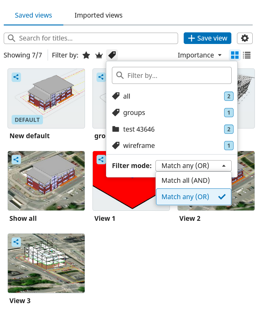

Three filter buttons are available in the Filter & Sort Bar:
AND / OR Tag Filter Mode
✨  New Feature
New feature: When filtering by two or more tags, you can now toggle between AND and OR logic.
Match any OR (default) — Returns views matching any of the selected tags.
Match all AND — Returns only views that match all selected tags simultaneously.
The AND/OR preference persists across sessions as a personal user setting.

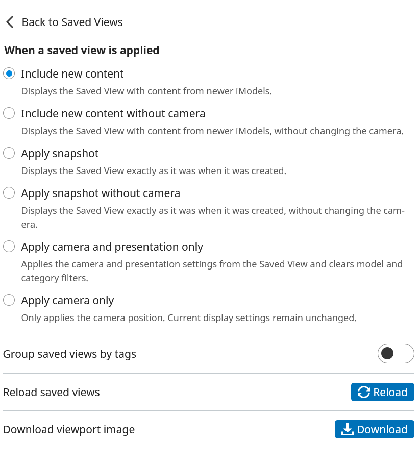

When a Saved View is Applied
These options control how content and camera settings are handled every time you apply a saved view. Select the mode that best fits your workflow:
Mode
Camera Applied?
Includes New iModel Content?
Include New Content  (Default)
Yes
Yes — shows content added after the view was saved
Include New Content (No Camera)
No — camera stays where you are
Apply Snapshot
Yes
No — shows only content present at the time of saving
Snapshot (No Camera)
Apply Camera and Presentation Only
Yes
N/A — model and category filters are cleared
Apply Camera Only
Yes
No change — all other display settings remain as-is
✨  New Feature
New in this release: Include New Content (No Camera) and Snapshot (No Camera) are two additions.
Both let you update what is displayed without moving your viewpoint — ideal when you need to apply presentation rules to your current camera position.

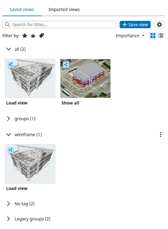

Above shows the saved view organised into hierarchical folder based on their tag information.
4. Organising Saved Views with Tags
✨  New Feature
New feature: Hierarchical grouping and keyboard tag entry are both new additions to the Saved Views widget.
What Are Tags?
Tags are short labels you attach to a saved view to categorise it. They serve two purposes:
Adding and Editing Tags
To add a tag to a saved view, open the Options (⋯) menu on the tile and select Add / Edit Tags.
Keyboard Support for Tag Entry
When the tag input field is active:
The tag appears in the list instantly after Enter is pressed. No separate confirmation button click is required.
Grouping Saved Views by Tags
Enable the Group Saved Views by Tags toggle in the Settings panel to switch from a flat list to a hierarchical folder-like view.
How Groups Work
Search and Filter with Grouping Active
AND / OR Logic with Tag Filters
When Group by Tags is active and multiple tags are selected as filters:
This combination lets you precisely narrow a large library of views without losing the folder structure.
