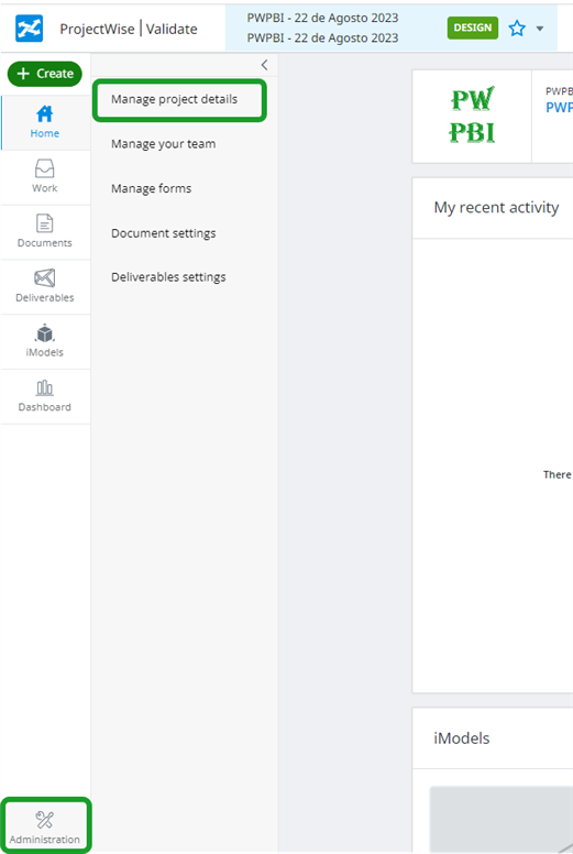

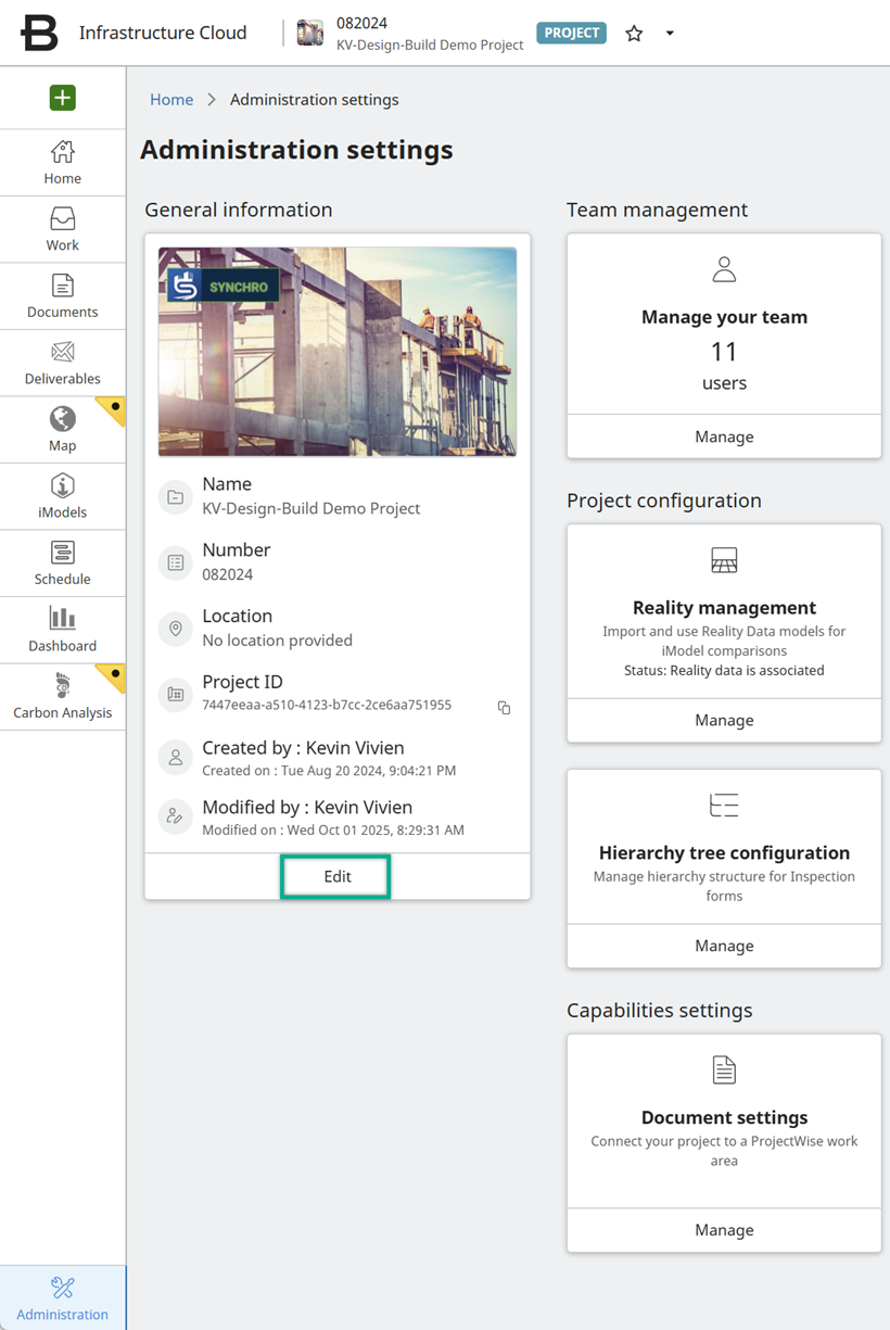

Modify project details
To access Manage project details, from the left Menu bar, select Administration the click Edit from the General Information tile.

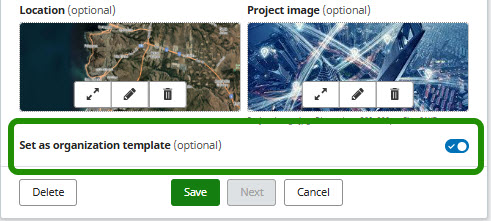

Set project as Template
At the bottom of Project Details page, enable the checkbox Make available as Template
Next time you Create a project, you will be able to select this one as template.

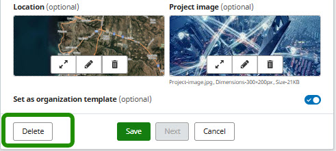

Delete project
To delete a project, select the Delete button from the Edit project panel

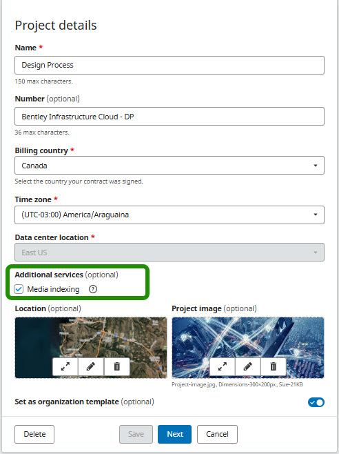

Modify project attributes
As mentioned above, you can modify any project attribute, except Data Center.
If you want to Index all the pictures added to forms or to the Document Storage area, just turn on Media Indexing.

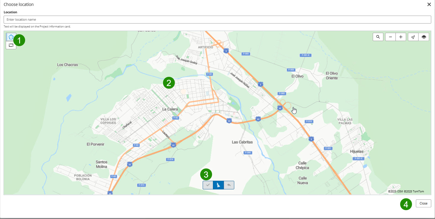

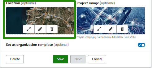

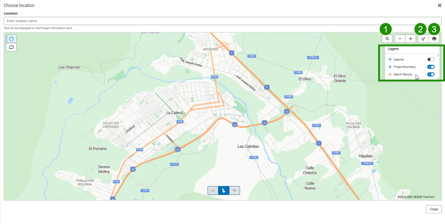

To add a Project Location, click on the + (plus) button. (Project Location description is a manually entered field, it will not auto populate once location is defined)
Once the Map opens, use the search tool (1), or navigate to your project's location (2). If you want, you can Turn On / Off the satellite image (3).
Using the drawing tools (1) on the top left corner you can draw a border (2) around your project area. Once completed click the check mark (3) to load the bordered location. Close to return to the Edit Project Details.

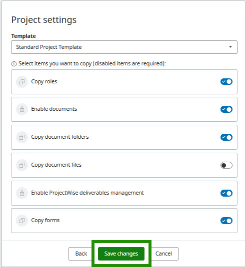

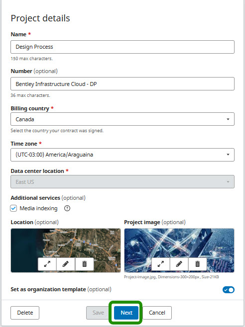

Project Reprovisioning

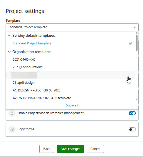

From the Edit Project page, click the Next button to Pick the project Template to be used for reprovisioning.
Pick up a project from the Organization project template and click the Next button.

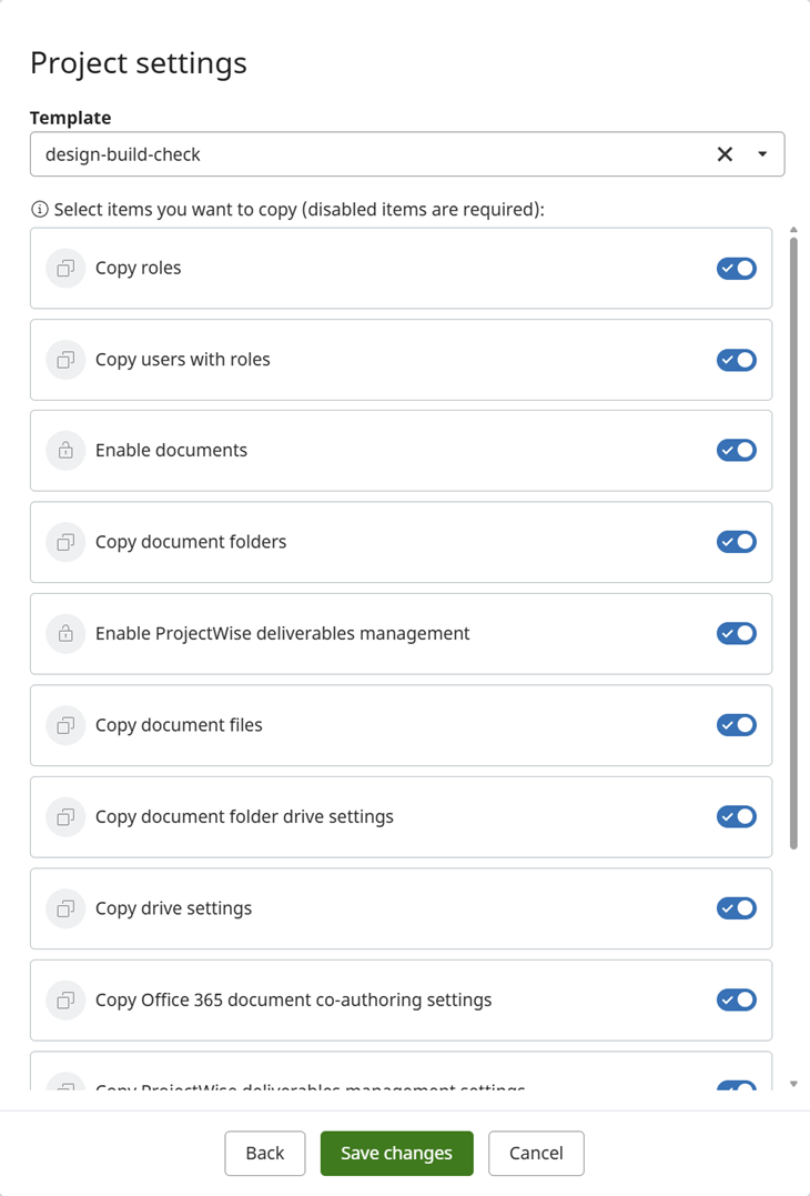

From the Project Settings dialog select which items to copy from the organization template and click Save changes.
[Note: Only forms that are in the Published status when the Template is created will be copied over to the new project]
