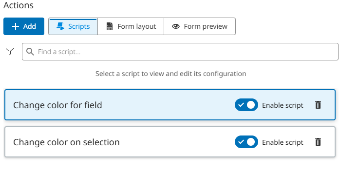

- If there are already Actions available, they will display in left pane of the Actions Designer interface.
- To edit an existing script, select it from the list of scripts and the actions will be displayed in the right pane.

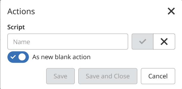

- To create a New Script, click the Add:
- Enter a name for the script and click the
icon to open the script editor.

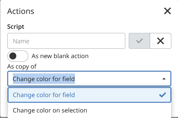

To copy an existing script:
- To copy an existing script, disable the 'As new blank action' option:
- Enter a name for the script and from the 'As copy of' dropdown, select the script to copy and click

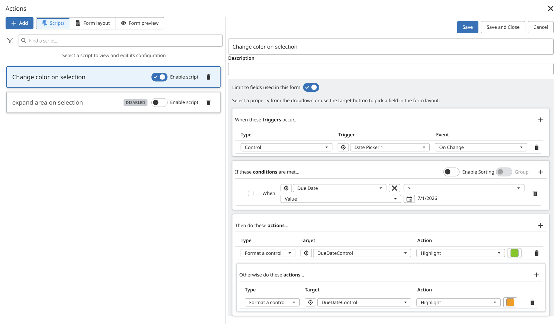

Defining the Script

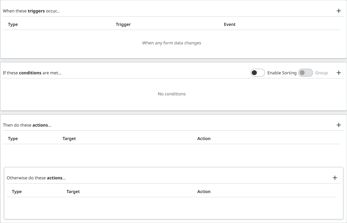

Scripts are made up of 3 segments (Triggers, Conditions, and Actions) that are dependent of each other based on a hierarchy from top to bottom.
Every segment does not need to be populated for the action to work. Certain scripts may only need a Trigger paired with Actions, or Conditions paired with Actions. The values selected in each segment will build a script to create the required action in the Form.
When these triggers occur…
The Trigger section defines what will initiate the action.

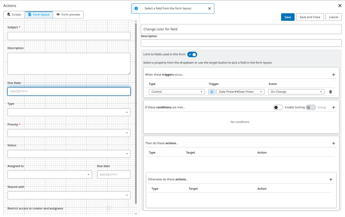

- Controls and bindings can also be selected directly from the form layout, instead of relying only on selecting control names.
- Clicking the form layout tab or the
button, switches the left-hand pane to the visual layout view.
- If you first select the
button, controls can then be selected directly on the form. (In the image below the Due Date field is selected in the form layout and the Trigger field is automatically populated.)

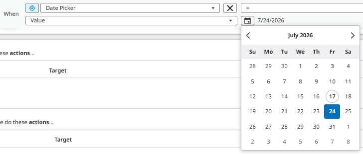

If these conditions are met…

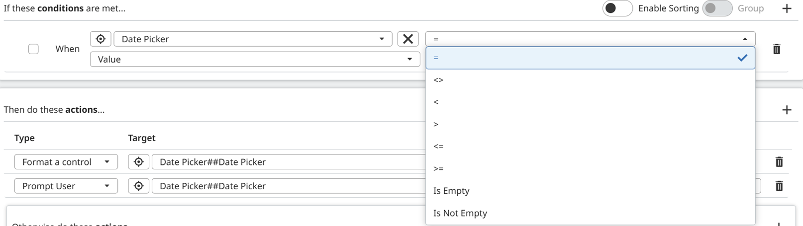

The Condition section identifies what specifications are requires for the action. When a Binding meets a certain condition, it will allow the action to happen.
- To add a Condition, click the
button. More than one Condition can be added if required. To delete a Condition, click the button.
- Select the required Binding, then select the desired Condition from the dropdown list.
- Depending on the Condition selected, a Value or Binding will need to be selected.

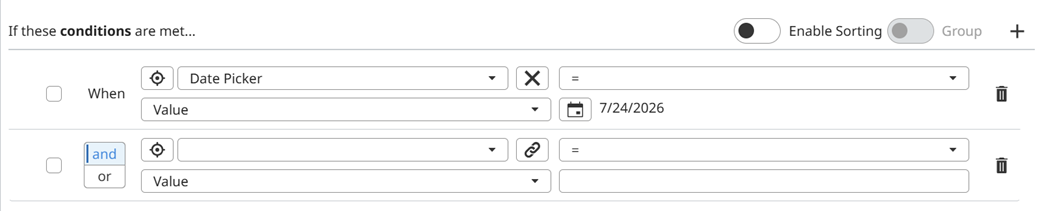

- In this below example a specific date (July 24, 2026) needs to be selected on the Due Date property on the form for a certain action to happen.
- When more than one Condition is required, users have the option to use and or or on addition conditions.
Then do these actions…
The Action section defines what will happen once a Trigger or condition is met.
- To add an Action, click the
button. More than one Action can be added if required. To delete an Action, click the
button.

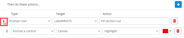

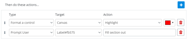

- Actions are based on a hierarchy from top to bottom. To adjust the order of the actions, click the and move the action.
- The action Type determines what sort of action is required.
- Format a control: Changes the control format such as the color, enable, disable, hiding, or showing the control.
- Change a value: Give a specific value to a control.
- Math: Apply basic math to a control or set of controls. (See Equation Builder below)
- Prompt User: Activates a popup window.
- Next, the Target will need to be identified. The Target list consists of the Canvas and any Controls that have been added to the Form.
- The Action defines the act that will take place. Depending on the Type selected will determine the options supplied in the Actions list.
In the example below the Format of the control identified in the target field will be Highlighted red depending on the Triggers or Conditions selected.

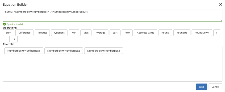

Equation Builder
When Math is selected as an action Type, the Advanced button will display. When you click it, the Equation Builder opens which allows you to perform automatic mathematical calculations using the data entered into your form fields. By setting up specific triggers and conditions, you can use the Equation Builder to automatically calculate and populate a target field (e.g., a total sum, an average, or a product) based on user input.
The Equation Builder window is divided into several helpful sections that allow you to construct your formula simply by pointing and clicking.
- Formula Input Box: Where the active equation is displayed. You can type directly into this box or use the buttons below to populate it.
- Operations: This section provides a library of pre-set mathematical functions. Clicking any of these buttons will insert the function into the formula box. Available operations include:
- Basic Math: Sum, Difference, Product, Quotient
- Statistics: Min, Max, Average
- Advanced/Formatting: Sqrt (Square Root), Pow (Power), Absolute Value, Round, RoundUp, RoundDown
- Number pad and symbol: Below the operations, you have quick-access buttons for structural symbols like parentheses (), Comma (,) and the minus (-) sign.
Note: You can also use your keyboard to type these, as well as commas , which are necessary for separating multiple items within functions.
- Controls: This section lists the dynamic fields (Controls) currently available on your form (e.g., NumberBox1, NumberBox2). Clicking a control button automatically inserts its unique reference tag (like <NumberBox4#NumberBox1>) into your equation, ensuring the system pulls the correct live data from that field.
As you build your equation, the builder will check your syntax in real-time.
- If the formula is complete and structurally correct, you will see a green checkmark indicating "Equation is valid."
- If there is a syntax error or missing element, the builder will provide an expected input warning to help you troubleshoot.
