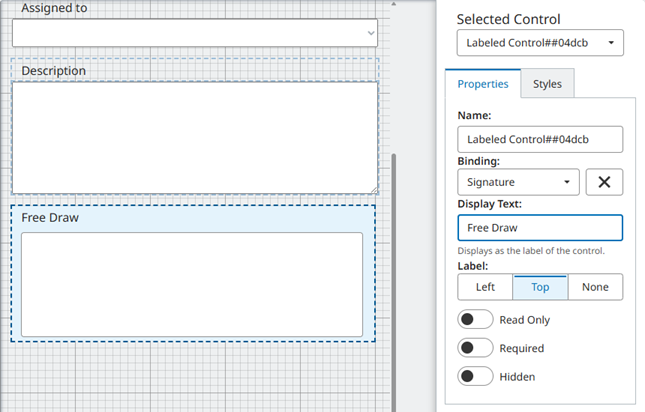

Free Draw
Free Drawing is a control that gives users an area to freehand draw anything they'd like. The result will be a PNG that can be treated as an "electronic signature" (rather than a "digital signature") if desired.
In the form, the Free Draw control lets you draw whatever you want on the canvas then accept the drawing. If the user is not satisfied with the result, they will be able to discard it and try again.

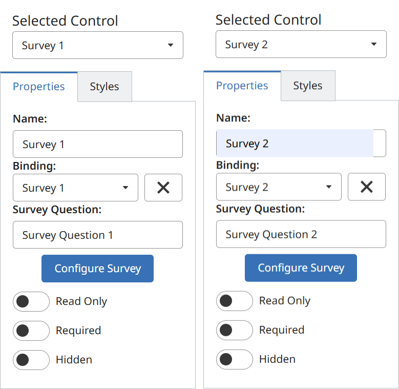

Survey
Survey Control displays a survey question in the published form with a set of predefined responses for the user to select from. Mulitple survey controls can be positioned on a form with different questions/responses defined for each.
- Click Configure Survey from the Properties tab to customize the content of the survey control.
- The following dialog displays:
- Survey Question: The survey question which displays on the form will be entered here.
- Responses:
- None: Explanation box is not displayed.
- Required: Explanation box will display with a required entry.
- Response Label: This is a set of customizable response to the survey question which will display under the survey question. Responses can be added by clicking the
icon, or removed by clicking the
icon.
- Response Style: Set the response to Positive, Negative or Neutral.
- Explanation Allowed: For each response is the option to display an explanation box for the user to enter details for the response.
- Properties for the Grid control column types are the same as the corresponding Basic Control. For more info about these properties, refer to the Basic Controls section.
- Each survey control will have a unique Name and Binding.
- Enter the name into the field and either select a binding from the drop down or click the
icon to select from the dialog or create a new binding. (Refer to the Bindings section for details)
Properties for a Survey Control include:
- Read Only: Makes the control appear grayed outby enabling the option.
- Required: Force the user to enter data by enabling the option.
- Hidden: Hides the control in the form instances.

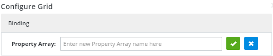

- After the Configure Grid dialog opens, select an existing Property Array from the list of the Binding section.
Or add a new property array by clicking the Add Property Array
icon, typing the name of the new property array in the Property Array field, and clicking the
icon to confirm the property array. If you have entered an incorrect property array, you can click the
icon.

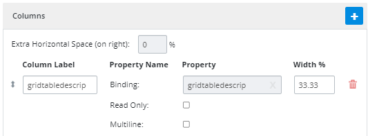

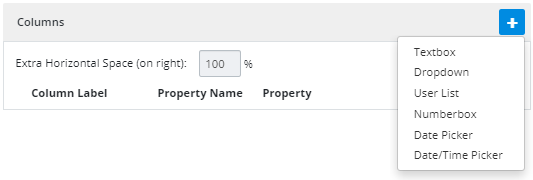

- Once you have selected a property array, add columns by clicking the Add Column
icon from the right side of the Columns section. You will need to select a column type for the dropdown list.
- To delete a column, click the Delete Column
icon. You can move a column to a different position in the order of columns by clicking the
icon. Enter a name for each column in the Column Label field. When you are finished configuring the grid, click Save.
Properties for the Grid control column types are the same as the corresponding Basic controls. For more info about these properties, refer to the Basic Control section.
- Binding: Click the
icon to add a binding. To remove an existing binding, click the "X" icon. Note: Bindings are optional for the Column control.
- Width % field, enter the width of the column in percentage.
Note: The ‘Extra Horizontal Space’ feature above the column info will calculate the remaining percentage available to be used for addition columns.

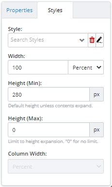

- You can edit the appearance of the Grid Control from the Style Pick from an existing Style or create a new Style. You can enter the width of the entire grid in the Width field. In the Height fields you can enter the Min and Max height of the entire grid. In the Column Width field, you can enter the minimum width of each column.
Note: To ensure that users can add rows in the published form, it is recommended to enter a height of 200px or higher.

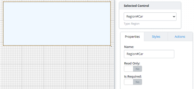

Region
Region is a place holder that can highlight and contain groups of controls.
Why we use regions:
- Highlight a certain segment of the form using the Style
- Combine a group of controls that have similarity such as function, purpose, time frame etc.
- There is purpose to hide and show some controls.

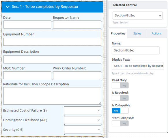

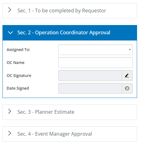

Section
Section is similar to a Region, but it has more options, such as adding a Title and making it collapsible.
Why we use Sections:
- Separate segments of the form into defined sections with titles.
- Create collapsible sections for ease of use in the field. Reducing the need to scroll for information on longer forms, open and collapse field as needed.
Properties for the Grid Control include:
- Is Required: Force the user to enter data by enabling the option.
- Is Collapsible: Allows the control to be collapse and expanded as needed.
- Start Collapsed: Give the option to have the Section control start in the collapsed position.

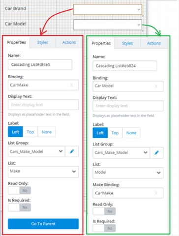

Cascading List
Cascading List control is used when the value selected on one list determines the values that is displayed on another list. Cascading List requires two or more controls. The first Cascading control is the master list, and the other Cascading controls are the sub lists.
- For this example, we want the form to specify the Make and Model of car. The first Cascading list control will be the Car Make list, and the second Cascading list control will be the Car Model list.
Note: The goal is when selecting a Make from the Make list, it activates which models appear in the model list.

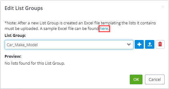

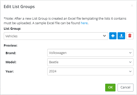

- Once the Cascading lists have been added and named, we need to define the List Group. You can select an existing list from the dropdown. To edit an existing list or create a new List Group click the
icon on the List group option.
Note: List groups are common across an organization, not per individual forms or projects. Editing or deleting a list group will effect all forms across the organization with the same list group.
- When editing an existing list group such as Vehicles, you can make changes to the value of the existing list group by uploading an updated excel document. The Preview section shows the master list, and the sub lists current values. We can select a Brand (master list), and see what option appears in Model (sublist 1), what option appears in Year (sublists 2).

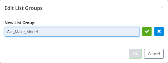

- To add a new List Group first give the List Group a name, then click
to save the new name.
- Next an Excel (.xlsx) list needs to be uploaded
Note: A sample file can be downloaded
and adjusted as needed.

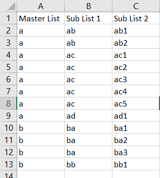

- To upload the list, we need to prepare the data in excel. Data can be prepared in multiple columns. The first Column is the Master List, and other columns are the Sub List. The first Row will be the Column Name.
2 Column Example:
3 Column Example:
Actual Data:
Note: Ensure there is no formatting or filters applied to the excel document before saving.
- The results can be checked now that the List Group contains data. Select a value in Master List (Make) and check the option in the Sub list (Model). If everything looks good, click OK.
Master List:
Sub list:
- Next, the Bindings must be created for each Cascading control. For this example, the Display Text Car Make and Car Model can be copied for the bindings.
- On the Properties tab a new option, Lists, has been activated for each Cascading list control. Select the required list for each control. Now that the lists are defined for each control, the Cascading List controls need to be bonded together. On the sub list Car Model control a new option, Making Binding, has been activated. The CarMake binding can be added to create a connection to Car Model.
- The Cascading List control is now ready to be published and used in the field.
