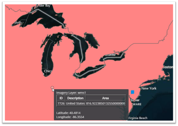

This option has some limitations. For example, it is not possible to select an element in the view and see the properties attached to it, unless the server is configured to support non-graphical query operations. If the server is configured in that way and that the “Locatable” option is turned ON in the settings panel, it will be possible to over the cursor on a tile and the associated properties will be displayed in a tooltip as below:

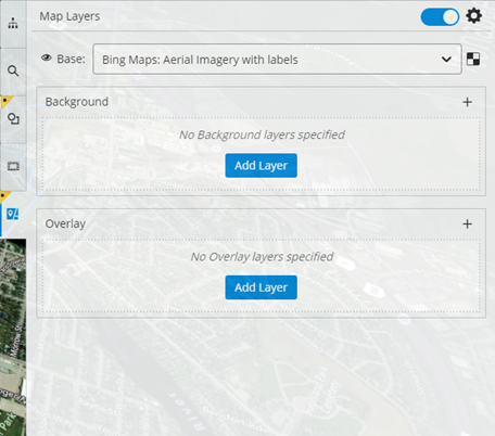

Base layer
Essentially, a Base layer shows geographic information displayed in the background. It provides context for additional layers that overlay on top of the base layer.

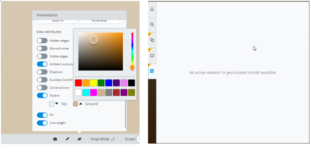

The Base layer is available if and only if the iModel is georeferenced. If not, the iModel will be displayed with the background color defined in the viewer presentation options and an information message displayed in the Map Layers widget:
The following Bing services are available in the list:
These layers above are present in the list as default, out of the box. The user doesn’t have to add them manually.
The visibility of the layer can be changed by toggling ON and OFF.
The transparency of the Base Layer can be modified by using the slider bar.
Background and Overlay layers
The user can add layers in the Background section and/or Overlay section. He can drag a layer from one section to the other, as well as ordering the layers within a section.
Background section – The layers added into this section will be displayed over the Bing layer but behind the iModel.
Overlay section – The layers added into this section will be displayed on top of all layers, including the iModel.

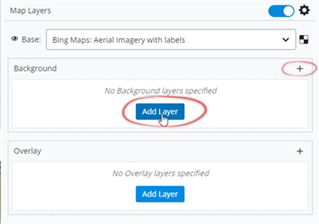

 Add new layer

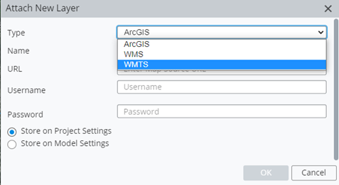

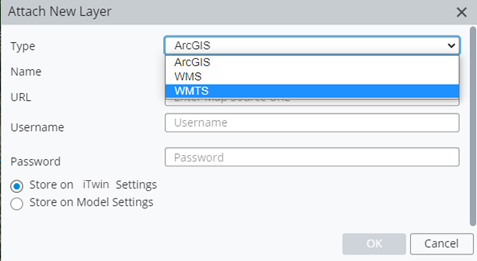

To add a new layer, click on the “Add Layer” button or on the “+” sign.
Attach New Layer dialog
Type
Select the type of service. The Background and Overlay sections allow to reference three types of GIS data:
* ArcGIS Identity (OAuth2) authentication protocol has been implemented in the Map Layers widget API. For more information on this topic, please follow the link below:
ArcGIS MapServer -ArcGIS Identity (OAuth2)

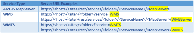

Type or copy the URL of the server to attach.
IMPORTANT NOTE: The resource must be served over HTTPS. Insecure resource will return error at attchment.
Here are some examples of URL that should be used:

Store on iTwinSettings
When this option is toggled on, the layer is stored on the iTwin settings. Thus, all iModels from a given iTwin will be able to attach the layer.
Store on Model Settings
When this option is toggled on, the layer is stored for the current iModel only. Thus, the layer will not be available for attachment to other iModels contained in the project.

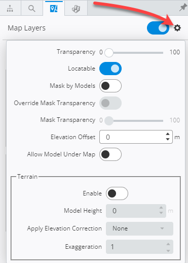

Settings dialog
Different settings are available in the Map Layers Settings panel.
Transparency
Use the slider to apply transparency on all layers from the Map Layers widget.

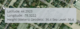

Locatable
Toggle ON this option to see the information and coordinates of the location pointed by the cursor on the Bing layer.
Mask by Models
Toggle ON this option to mask the map layers contained in the view. The iModel and the reality data serve as clipping element. This can be useful when the iModel contains elements located under the ground. Enabling the mask allows to see the underground portion of an iModel. When turned off, the map layers block the view.
See this video for more clarity.
Override Mask Transparency
By default, the mask will be applied with the same transparency value as the clipping element. For example, if the clipping element has a transparency of 50%, the same value will be applied to the mask. Each element has its own transparency value. It is sometimes required to override the Mask transparency and apply the same value globally. Use the Override Mask Transparency to apply a mask transparency value globally.
Use the slidder to set the value.
Elevation Offset (m)
Use this option to adjust the Map layers elevation to align with the iModel whenever necessary.
Allow Model Under Map
Use this option to allow the display of the underground section of the iModel under the map layers.
By default, the map layers are displayed in the background, completely behind the iModel and reality data, so that the user sees the model in its entirety, even the parts that should be displayed under the ground.
Terrain
The Terrain section contains options related to the display of the Cesium terrain layer.
Toggle ON the "Enable" option to activate the Cesium terrain layer and have a 3D view of the terrain surrounding the area of the iModel.
Model Height (m)
Use this option to adjust the terrain elevation so that it fits the model elevation.
Apply Elevation Correction
Sometimes the iModel is not displayed at the right elevation in Design Review. Most of the time this happens when the input design file was created with the wrong vertical datum; Ellipsoid instead of Geoid. So when the user turns ON the Cesium terrain, the elevation is incorrect. Another case is when the user has drawn his design at the right location but on a random elevation.
To correct the elevation
Exaggeration
Use this option to exaggerate the elevation of the Cesium terrain.
