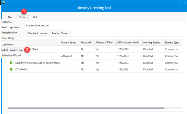

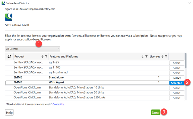

How can I use my AGENT add-on?
- Verify that you are using CONNECTION Client 11.00.05.44 or above. If not, please download and install the latest version from Software Downloads (bentley.com)
- Open the Bentley Licensing Tool from the CONNECTION Client
- Open the Feature Level Selector from the Tools menu.
- Click Select in the row with the EMME With Agent feature and click Done.
- You might need to restart EMME to have AGENT available for use.
