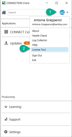

Verify that you are using CONNECTION Client 11.00.05.44 or above. If not, please download and install the latest version from Software Downloads (bentley.com)
Open the Bentley Licensing Tool from the CONNECTION Client

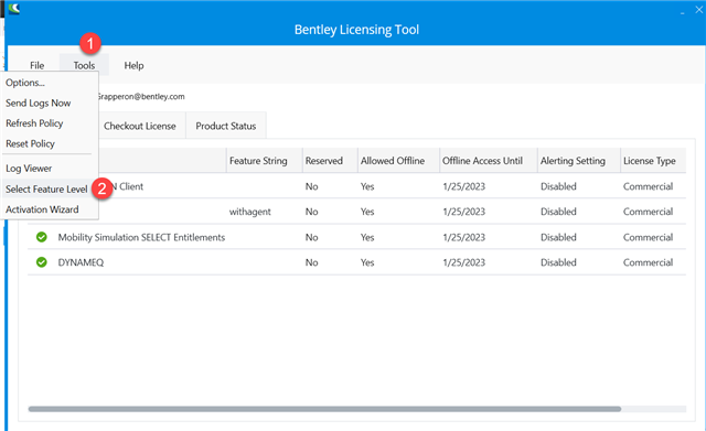

Open the Feature Level Selector from the Tools menu.

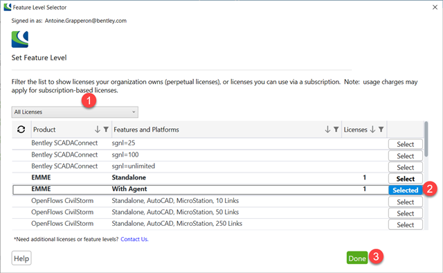

Click Select in the row with the Standalone or the EMME With Agent feature, depending on what you want to use. Click Done.
If EMME was already started, you need to restart EMME for this change to take effect..
