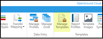

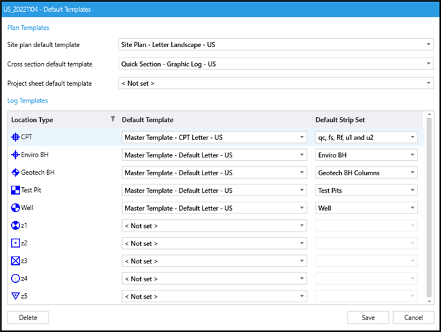

Starting at the config pack, you will find two buttons. The first will be the Manage Templates.
Under Manage Templates, you can define which template is used for a Quick Log or Quick Section. For the Quick Log, it's based on the location type. For the site plan and the Quick Section, there are single options for defaults.

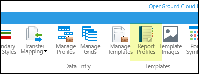

Manage Log Reports
Log reports are collections of reports for locations that get produced when selected together. The button we need is Report Profiles

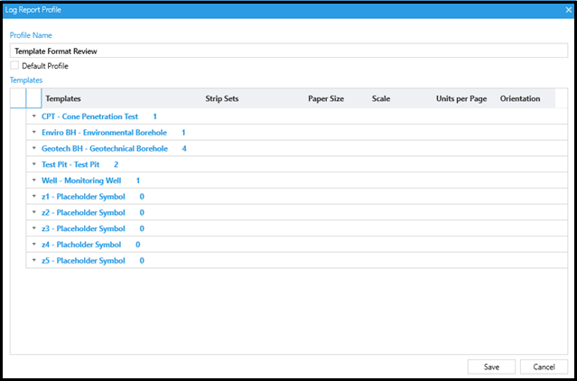

This immediately opens the Log Report Profile window.
This will work based on the location type again, but you can select any number of reports to produce for each single location type. For example, you might have your standard SPT location under the Geotech BH location type with just the standard log template. Then, for each location that has that type, you will get the standard borehole log. If you select an Enviro BH you might want to have the standard log plus a Well log produced.
You can have as many report profiles as you would need.
