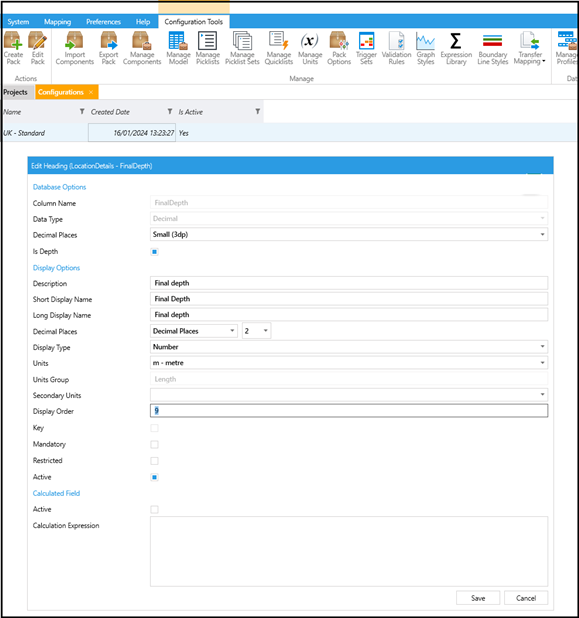

Changing the Order of a Grid in Professional
Changing the order of the grid you see when you load the data in Professional is a useful way to make the important data a focal point.
You can do this in two ways. One way is when you first set up the grid you can assign a display order number to the field which runs from 0 left to and in increasing values (=>1) to the right.
This isn't the most effective way to do it but it can be useful if you are adding additional fields to a Group/Table.
Top Tip: the number can be a decimal number this means you can use 9.1 if you want to put something just to the right of the final depth above.

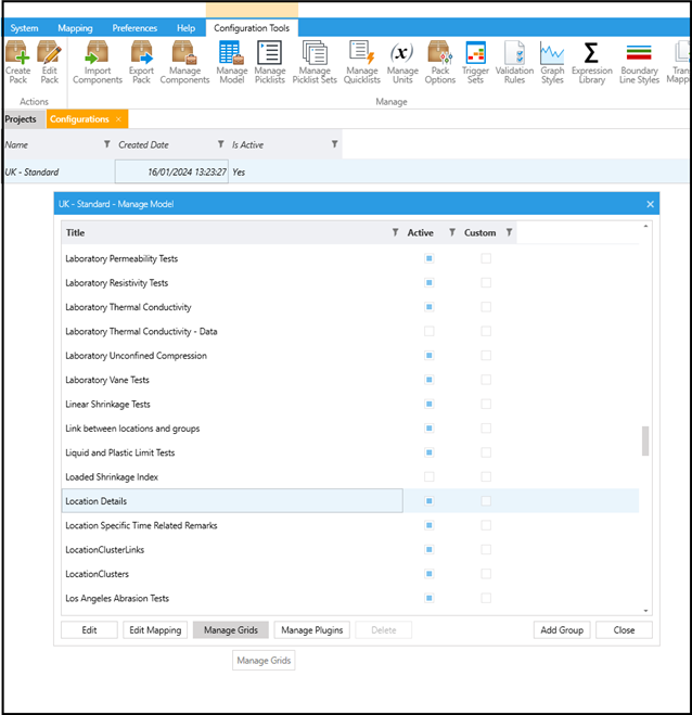

Changing the Grid View
Changing the Grid view means you can update the view you have of the Group/Table. This is done from the config pack with the Manage Grids Button when you select a Group/Table after selecting the Manage Model icon.
You can update this by following this guide
