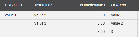

FirstData()
FirstData() can currently only be used in Model Calculation expressions. It can't be used in other Expression Engines.
Accepts a series of arguments and returns the value from the first argument that contains data (that is not null).
All arguments must have the same data type. If a value is of a different data type, it can be cast to the consistent data type using a function like value() or text(). See the example below where this is done with text() to include a numeric value within the function call.
FirstData(value1, value2, value3,...)
Example:
This expression will return the results shown below in the FirstData header:
FirstData(
  TextValue1,
  TextValue2,
  text(NumericValue3)
Note that FirstData() does not treat an empty string as equivalent to null. For example:
FirstData(
  'ABC'
will return '' (an empty string)
However, this expression:
FirstData(
  null,
  'ABC'
will return 'ABC'

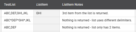

ListItem()
ListItem() can currently only be used in Model Calculation expressions. It can't be used in other Expression Engines.
Retrieves an item from a delimited list.
ListItem(List,Delimiter,Item)
Examples:
This expression will return the results shown below in the ListItem header:
ListItem(TestList,',',3)

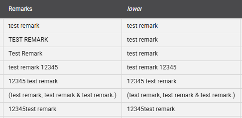

lower()
lower() can currently only be used in Model Calculation expressions. It can't be used in other Expression Engines.
Lowercases all characters in a text string.
Examples:
This expression will return the results shown below:
lower(Remarks)

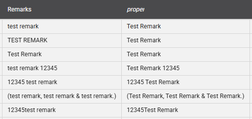

proper()
proper() can currently only be used in Model Calculation expressions. It can't be used in other Expression Engines.
Uppercases the first character of each 'word' within a text string and lowercases the remaining characters. A 'word' is defined as any group of letters occurring at the start of the string or after a space or any 'non-letter' character.
Examples:
proper(Remarks)

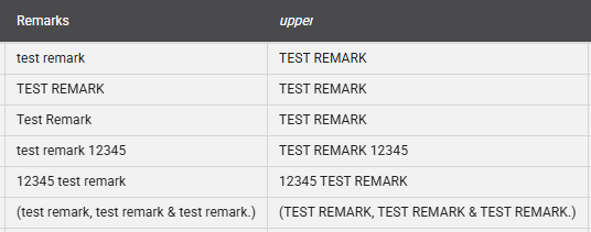

upper()
upper() can currently only be used in Model Calculation expressions. It can't be used in other Expression Engines.
Uppercases all characters in a text string.
Examples:
upper(Remarks)

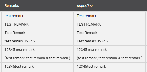

upperfirst()
upperfirst() can currently only be used in Model Calculation expressions. It can't be used in other Expression Engines.
Uppercases the first character of a string and does not modify any other characters within the string.
Examples:
upperfirst(Remarks)
