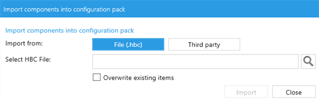

To import charts follow the steps below:
 You can copy a chart from one configuration pack to another by first exporting it and then importing it using the steps below.

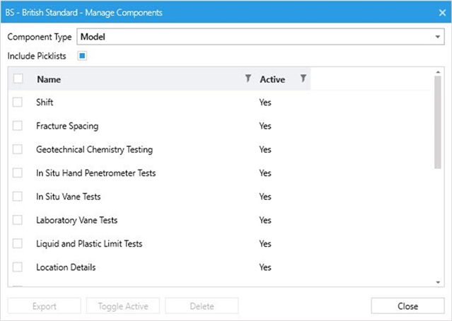

The user will then be prompted to save the file into a relevant location and give a suitable file name. Note that the exported file is a *.hbc file.

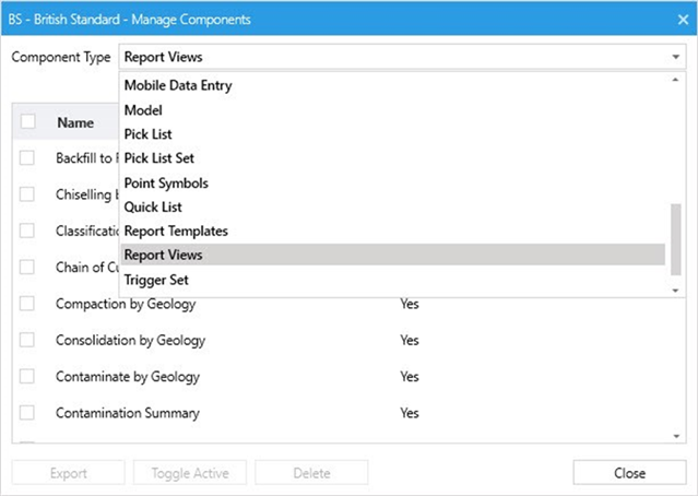

The exported file will contain the Chart definition and any Line Style Set and Marker Set that is used in the Chart.  It does not include the point symbols used in the Marker Set – these can be exporting using the same method above and selecting the Point Symbol component set.
