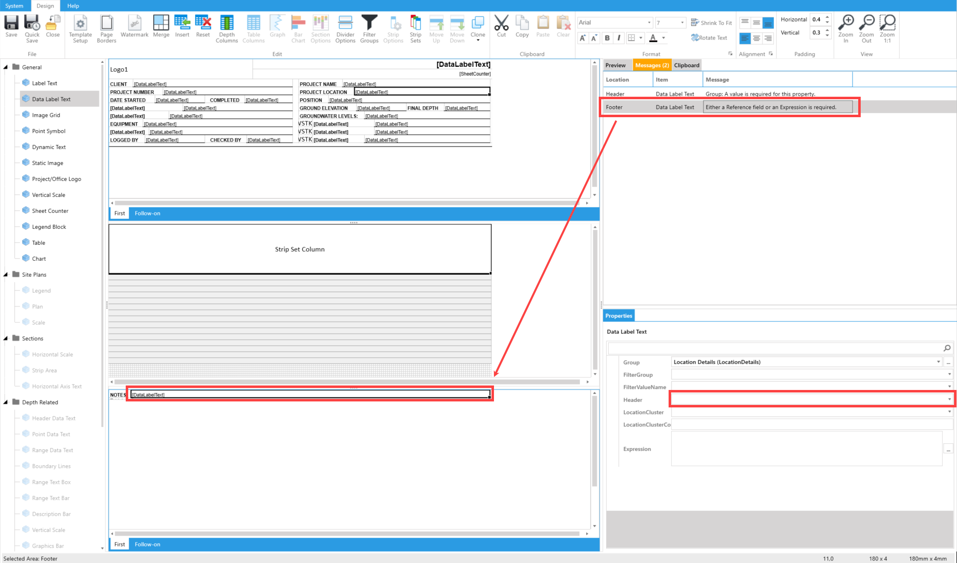

Troubleshooting and Modifying Component Examples
We aim to publish component examples that work across both new and legacy configurations, but some customization may be required for your specific setup - especially when extracting components from newer configuration packs.
Common Issue:
A template references a Group or Header (directly or within an expression) that doesn’t exist in your configuration.
How to Diagnose and Fix:
  1. Open the template in Template Studio.
  2. Preview the template.
  3. Click on any error Message to highlight the object causing the issue.
  4. To fix:
    • Update the object's properties to match your configuration, or
    • Use Design>Reset to remove the object from the template.
