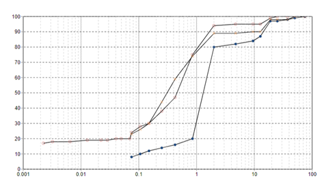

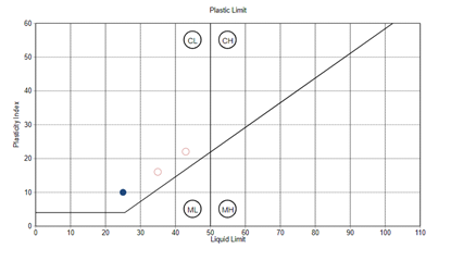

- Against data from the same table or from any parent/grandparent table, for example, moisture content against sample top, Liquid Limit against Plasticity Index, or size sizes against percentage passing.
- A fixed-point series to represent a line or set of points. This can be used to place fixed labels on a graph or to represent a fixed line.
- An expression series where the data is based on an equation - for example, an Air Voids line.

Two Chart Examples
