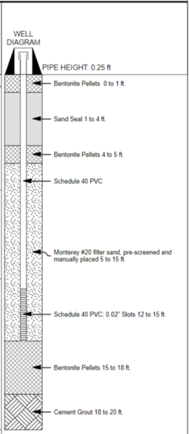

Let’s say you have a Well Diagram (graphic) column and Well Details (text) column describing the well graphics. Between these two you want to have pointers, that is, a pointer between the text and the graphic it describes. Below is an example:

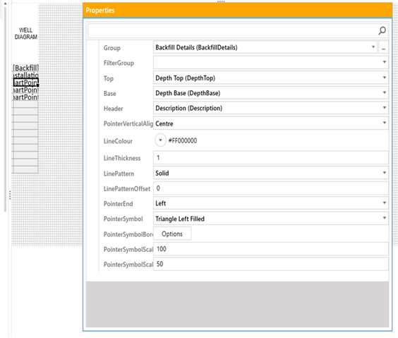

The “Description” header (field) is used on both the smart pointer and the text object.
Template Studio Properties for the Well Diagram column on the Smart Pointer for Backfill

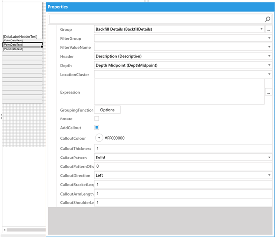

Template Studio Properties on the Well Details column for the PointDataText item for Backfill

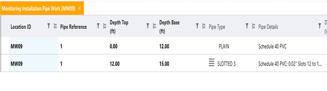

2.  Pipe Work Data Entry and Template Studio settings
Pipe Work Data Entry example for well diagram above:

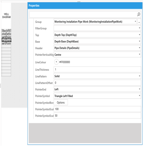

The above Well Diagram was created with the following Template Studio Settings.
The “Pipe Details” header (field) is used on both the smart pointer and the text object.
Template Studio Properties for the Well Diagram column on the Smart Pointer for Pipe Work

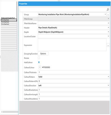

Template Studio Properties on the Well Details column for the PointDataText item for Pipe Work

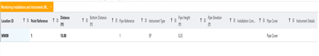

3. Monitoring Installations and Instruments Data Entry and Template Studio settings
Instruments Data Entry example for well diagram above:

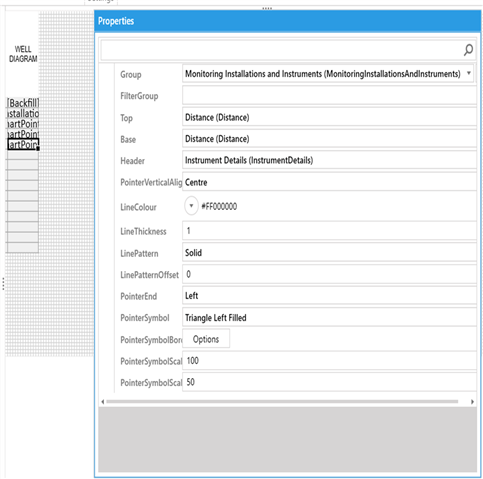

The “Instrument Details” header (field) is used on both the smart pointer and the text object.
Template Studio Properties for the Well Diagram column on the Smart Pointer for Instrument
