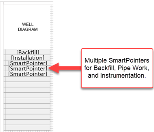

To insert a Pointer Object into a backfill or instrumentation column, follow the steps below:
- Select the first empty box below the backfill and instrumentation objects in the column that the item is to be added to.
- Double click on the Pointer Object in the Depth Related section of the left hand side tree view.
- The Pointer Object will now be added and the text "[Smart Pointer]" is inserted in the cell.
- Define the additional properties for the object in the properties box.

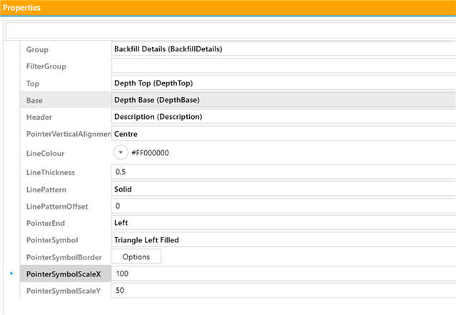

- Group - the grid that the data is being linked to.
- Depth Top - the field that defines the top depth.
- Depth Base - the field that defines the base depth.
- Header – Pick the header (field) the pointer will be based on. For example If this header has data for a record then an arrow will display.
- PointerVerticalAlignment – sets the vertical alignment of the text with respect to the depth range fields. Center will be used in almost all use cases.
- LineColour – Sets the colour of the line on the smart pointer. Default is Black.
- LineThickness – Sets the thickness of the line on the smart pointer.
- LinePattern – Sets the type of line. Default is set to solid.
- LinePatternOffset – Default is 0
- PointerEnd – Set what side of the line the pointer end will be located. For an Arrow that is on the right side of the column use left.
- PointerSymbol – almost all use cases will be an arrow. For example Left Arrow.
- PointSymbolScaleX – Set the x scale of the point symbol. Default is 100.
- PointSymbolScaleY – Set the y scale of the point symbol. Default is 100.
