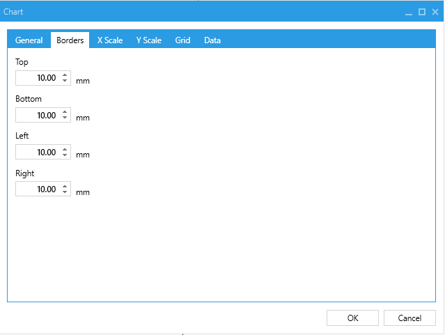

Border Properties
The border area is the outer border of the chart. It’s the space around the chart rather than the line work on the edge.
The space given is the space defined on the template, which you can see in the bottom right-hand corner of Template Studio.

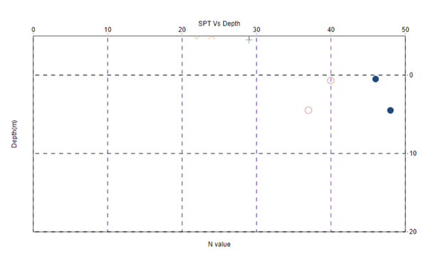

Positive Direction:  This check box determines whether the scale increases to the left or right and up or down.  Positive means increases to the left or up.  Turn this off reverse the direction of the axis.  For depth plots ensure that this is turned off for the Y axis (as shown below).

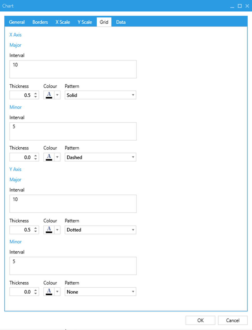

Grid Properties
The grid tab allows you to set the major and minor gridline styles for both the X and Y Axis
The tab is self-explanatory; however, you must set a thickness and a pattern for a gridline to be displayed. Setting the thickness to zero or the pattern to nothing will hide the gridline.
Major and Minor interval values can be fixed values by simply entering the number of each. However, like the scales, these can be powerfully controlled using expressions.

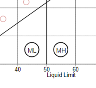

Set the type of markers and the Scale.  It is normal to leave the scale set to 1.  Marker Sets are set up in the Symbol Set Manager.
Setting the scale to be larger with circle outline symbols can be used to highlight the labels, as shown below.

Order
The order which the datasets are drawn can be important.  The higher the number the later the series is drawn.  For example setting the A line to be Order 0 and the Data points to be 1 will draw the points over the top of the A Line.
