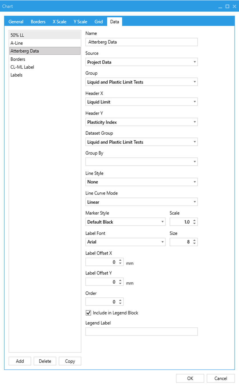

Creating a Data Series
There a three main ways that data can be shown on a Chart:
They are selected from the Source drop-down on the Chart Data tab.

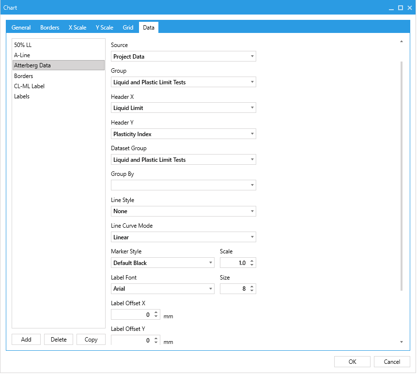

Project Data
The most common type of data to be plotted on a chart is the data from your database.  This is referred to as Project Data in the Source dropdown.
To specify this series type, you must select a Group and then select an X and Y column from that group.
Dataset Group
The dataset group is the combination of results. For example, if you want to show the data from a PSD on a plot, your group and x and y will be on the PSD data group but we only want a single line per PSD General. We would set the dataset group to PSD General. This will then make a single line or each of the PSD General rows with the data from the correct table.
In simple terms, it's the grouping of the data together by a parent record.
For more information on the Dataset Group, please see the Lab Administration Guide.
Group by
You can group by any field within the selected Group, parent groups, or depth-linked table.
Each group will be displayed with the next line style and symbol in the selected sets.  Create a line set /symbol set with a single style if you wish to display all the groups similarly.
Note: You can currently only group by a single parameter – if you need to split by multiple parameters, then you need to create a concatenated string in your Group and then select this field to group by.

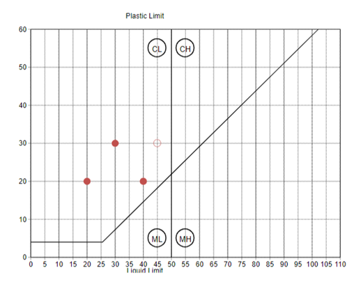

Creating a Fixed Point Series
Fixed points are the second most common series type.  These can be used to draw fixed lines (such as A Line or Sieve Sizes on charts) or can be used to position labels at fixed points on a chart.
To create a set of points, you need to define the coordinates of the points in simple x,y format with each point on a separate line.  Please note that no spaces are allowed between the values and the separator must be a coma.
0,0
10,10
To add labels to the data points, the label must be defined before the data, as shown below:
ML,45,5
MH,55,5
CL,45,55
CH,55,55
The example below shows 3 fixed-point datasets:

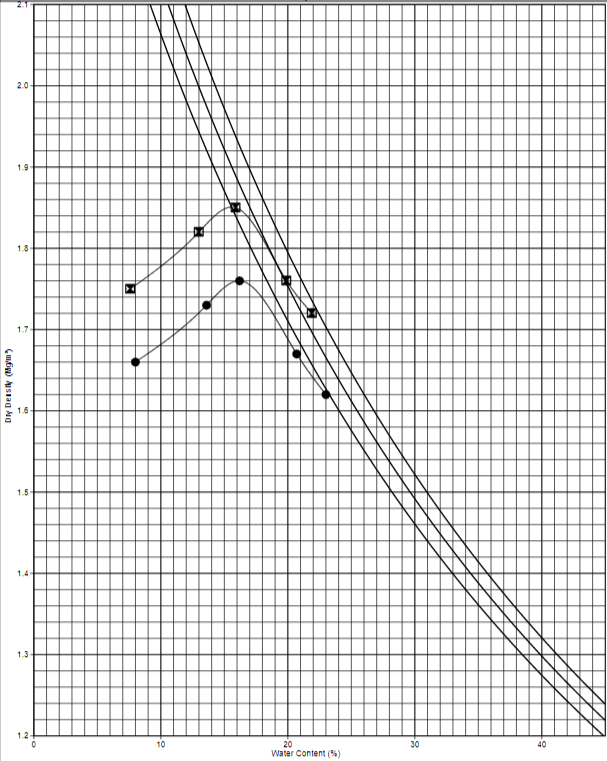

Expression Series
An expression series is a powerful way to add a line or set of points to a chart that is defined by an equation.  For example a zero Air Voids Ratio line on a compaction test or a circle on a Mohr’s circle plot.
Any field that can be used for the group by parameter can be used in the expression.  To reference fields you must use the [GroupName.FieldName] format as shown below:
5% Air Voids Line
y = (1-(5/100))/((1/ [CompactionGeneral.ParticleDensity])+(x/100))
Circle of 10 radius centred on 30,30
y = 30-Sqrt(Pow(10,2)-Pow((x-30),2))
For example, a proctor/compaction curve would use expressions.
