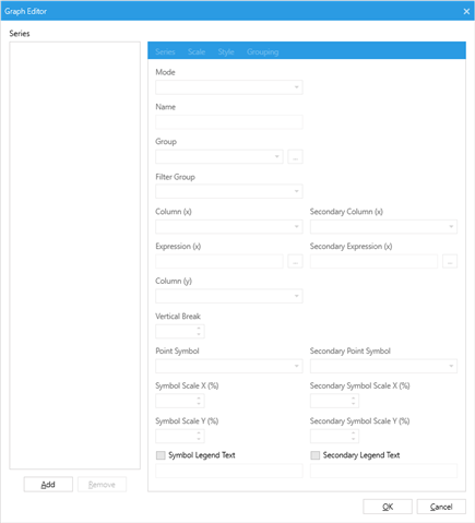

Double click on the Graph in the Depth Related section of the left hand side tree view.
The Graph Object will now be added and the text "[Graph]" is inserted in the cell.
Note: There are no properties window to use as there are too many properties and therefore the Bar Chart Editor opens up.
A graph comprises of four things: (1) Series, (2) Scale and (3) Legend (4) Grouping (These are the three first tabs on the right of the series text box).
