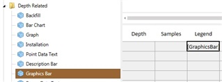

The Graphics Bar object displays the geology hatching and other hatching in the column.
To insert a Graphics Bar object into a column, follow the steps below:
It is possible to have a second column with a Graph object, e.g. Formation where the hatching will be defined by another code e.g. Geology Code as long as there are hatching images specified in the pick list manager in OpenGround Cloud .
The Graphics Bar can be combined with the Installation Object, but the Installation has to be first in the row and the Graphics Bar second.
