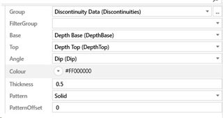

The Discontinuity Fracture Spacing Library Item allows for a fracture image to appear down a column depending on the angle of fracture in the data. The following settings are present in this item.
Group - This is the table that the data will come from. For standard use this should be set to Discontinuity Data.
Filter Group - If a filter group is being applied to the data to filter out certain data then set this here.
Base - This is where the bottom of the data will appear on the template.
Top - This is where the top of the data will appear on the template.
Angle - This is the data that will be used to determine the angle of the line used. This value is set from horizontal, so a value of 0 or 180 will appear as a horizontal line with 90 being vertical.
Colour - This is the colour the data selected underneath Angle will appear as.
Thickness - This is how thick the lines drawn under Angle are displayed.
Pattern - This is how the lines drawn under Angle are displayed.
Offset -This works alongside Pattern Offset to show the lines selected under Angle.
Pattern Offset - This works alongside Offset to show the lines selected under Angle.
