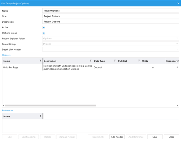

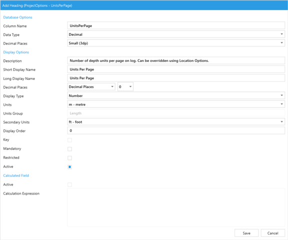

To set this up, you can add a Project Option group named ‘ProjectOptions’ with a ‘UnitsPerPage’ header. (You can name the group and header whatever you'd like, but these are the names used in this example.)

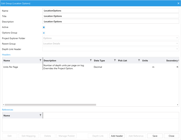

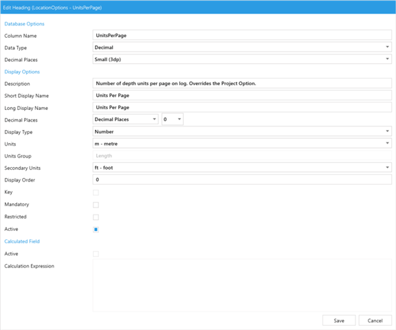

You can also add a Location Option group named ‘LocationOptions’ with a ‘UnitsPerPage’ header.

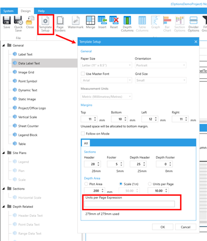

To control how the Options groups are used when generating logs, you will need to open your Borehole Log template(s) in Template Studio and enter a ‘Units per Page’ expression under Design>Template Setup.
The expression we will use is:
if(isblank([LocationOptions.UnitsPerPage]),[ProjectOptions.UnitsPerPage],[LocationOptions.UnitsPerPage])

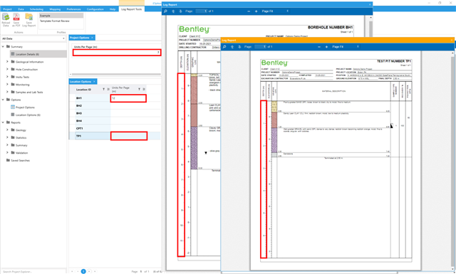

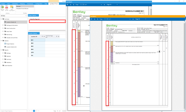

First, we’ll enter a Project Option of 7 Units Per Page, (Save), and generate Log Reports and see that both Locations now show 7 m per page:

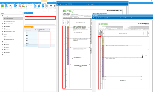

Then we will add a Location Option of 12 m for BH1 and see that it now shows 12 m per page, while TP1 without a Location Option stills show 7 m per page (using the Project Option).

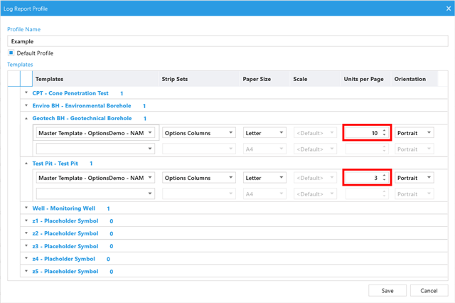

Then, we will remove all of the Options and see that the Log Reports default to our settings in our Report Profile, in this case 10 m for Geotech BH ‘BH1’ and 3 m for Test Pit ‘TP1’.
If the ‘Units per Page’ expression does not return a value, such as if a Project or Location Option is not entered (as above), it will use the default Units per Page defined in the template or Report Profile when generating Quick Logs or Log Reports.
