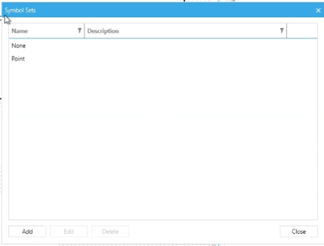

Adding / Editing a Symbol Set.
Symbol Sets can be added and edited using the “Add” or “Edit” button on the Symbol Set Manager (as shown below)

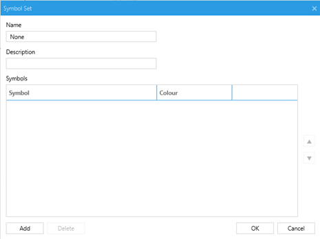

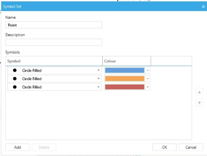

Each Symbol Set has the following properties: Name, Description, and a set of symbols.  These are shown in the Set Manager form below.
When adding Symbols to a set, it is vital to use the symbols that start with the word “Chart”.  These symbols are colour-neutral and have their centre point at 0,0.  Many symbols, such as water strikes, are designed to appear above or below the insertion point have a fixed colour and will not display correctly for a point on a chart.

To create a “None” Style set create a new set called “none” and do not add Symbols to it as shown below.
